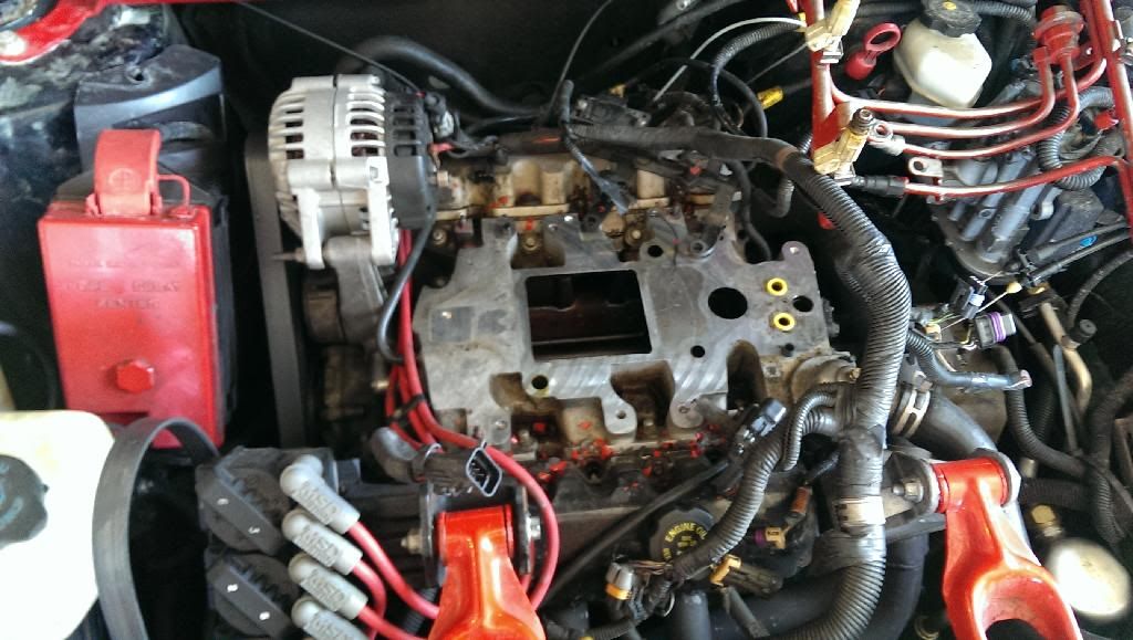

Well it's official. This old girl now has a working Gen V installed.
Everything went pretty smoothly. The Gen V whines quite a bit more than my Gen III did, and is quite loud on a 3.8" with the silencer ports closed. First start up and the LTFT's look great. +/-2 at idle so no vacuum leak, which is great since I used RTV only. Gaskets are for losers. Only mistake I made all night was I installed the TPS wrong, so when I went for my first test drive, the car wouldnt shift. I was a bit nervous. :th_nervous: But then it hit me, it's probably something simple like the TPS, which it was.
The car is KR free, which is a good sign and at the peak in this cold weather, I saw 8.5psi, which is giving me hope I might be able to squeeze a 3.4" on the Gen V when I do my rocker install. :th_king-evil:
*I do also plan on removing the blower during my next oil change to take a look at the silencer ports. Just make sure the QuikSteel isn't wearing away from the heat/pressure.
Off comes the junk Gen III, Garbage. Look at all that red paint that flaked off my fuel rails :(

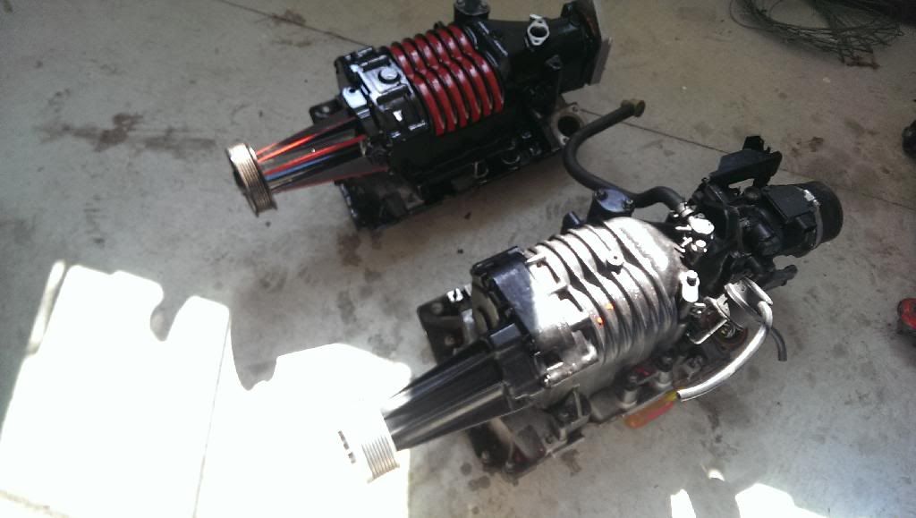

Old Vs. New:

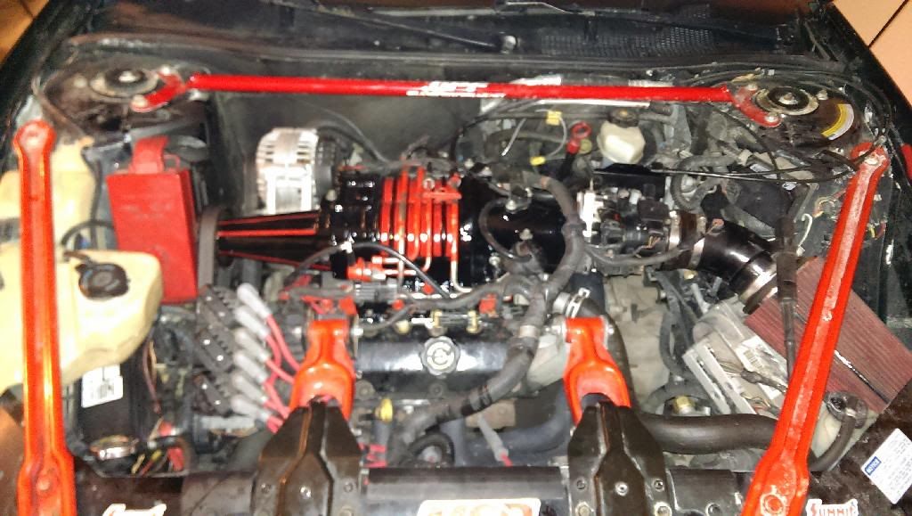

Sorry for the crappy picture. I'll have to get a better one tomorrow or something. It was dark outside and the flashed sucks. Anyways, here it is all finished:
