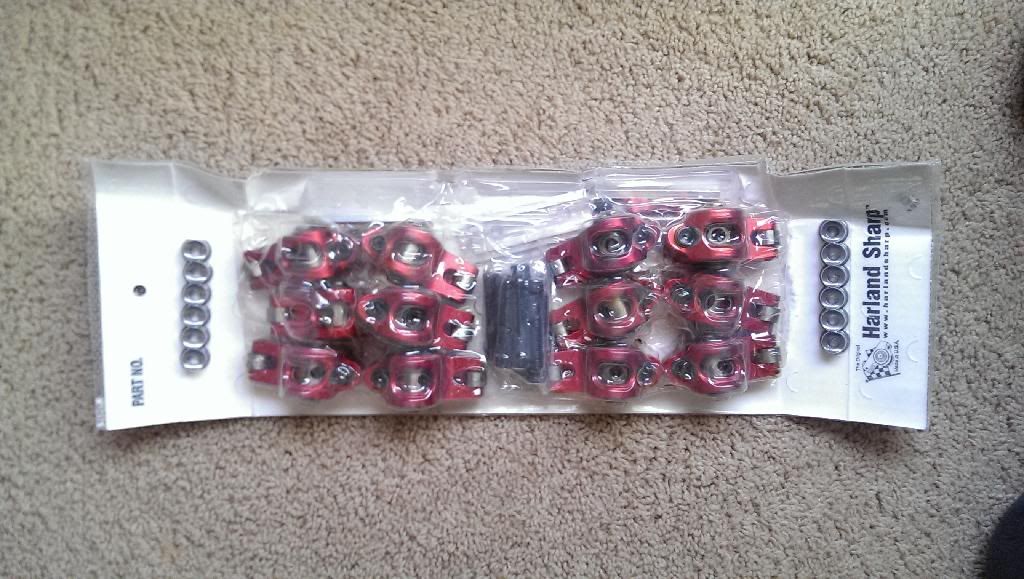

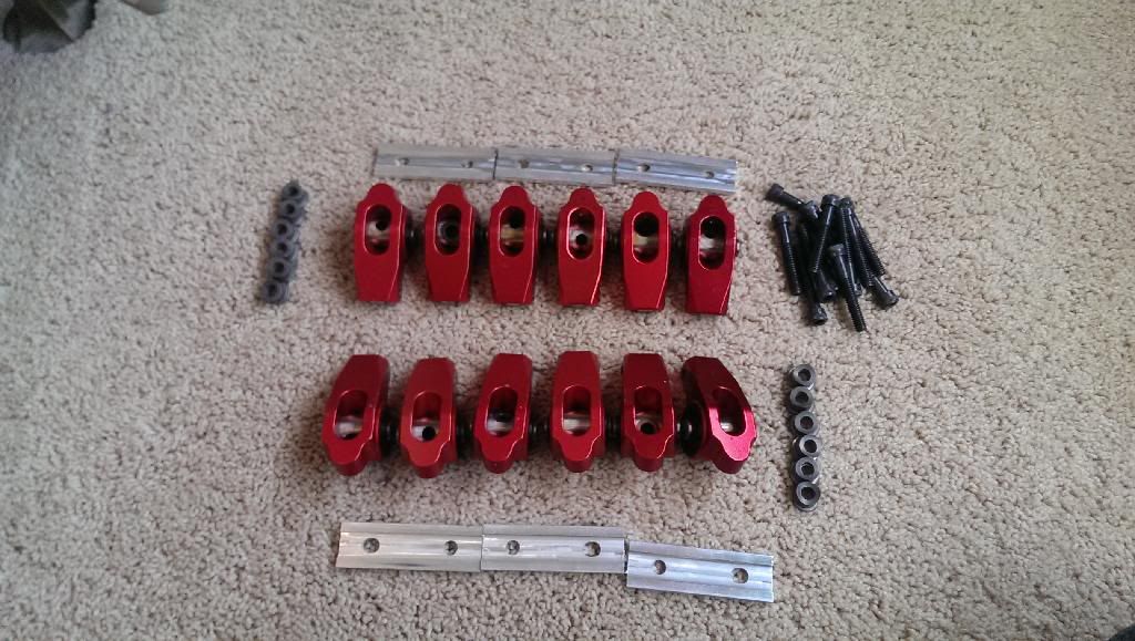

So after some thought, I decided to trade my 1.84 Yella Terra's for another set of rollers.
Reason behind this, is that I don't plan to cam anytime soon, if ever. So I'd like to make the most out of the rocker setup. Not sure on how much of a difference there is between 1.84 and 1.9 rockers, but every little bit helps.
Greg (GMR Badass) traded his 1.9 Harland Sharp Roller Rocker set for my Yella Terra's. Reviewing about Harland Sharp, they are hit or miss which made me nervous. But the ones he is giving me have been sent into Harland Sharp and have been updated to fix any old occuring problems with them.
Anyways, I'm debating whether to run 90# Yellow Ls6 springs or 105# springs. I've read on a Bonneville forum the Ls6 springs wont even work for the rockers. (Not sure how true that is).
Ls6 springs increase in pressure faster than 105's. Which in returns, wears out the Timing Chain Dampener quicker. Since I won't be going back into the valve train for a long time after the install, I'd like to do it right the first time.
I currently have the 90# Ls6 springs with Modded retainers. Should I sell those and pick up a set of 105's and use those with the modded retainers I already have?

Like I stated before, I decided to trade my 1.84 Yella Terra Rockers for another set of roller.
I ended up getting some 1.9 Harland Sharp Roller Rockers, that have been refurbished/updated. Not sure how much of a difference there is between 1.84 and 1.9's but since I won't be going into the Valve Train for a long time after this install, I want the most out of the Rocker set up.
After talking with Greg (GMR Badass, who I got the Rockers from), I have decided to go with L76 springs since they are 90# springs still, but have less Valve Lash compared to the Ls6 springs. Easier on the dampener. With that being said, I will be selling my Ls6 springs, incase anyone is looking for a set.
