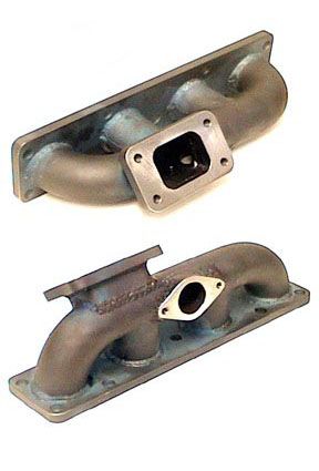

turbo manifold. do i plumb the wastegate back into the exhaust or be a ricer with a mini dump?

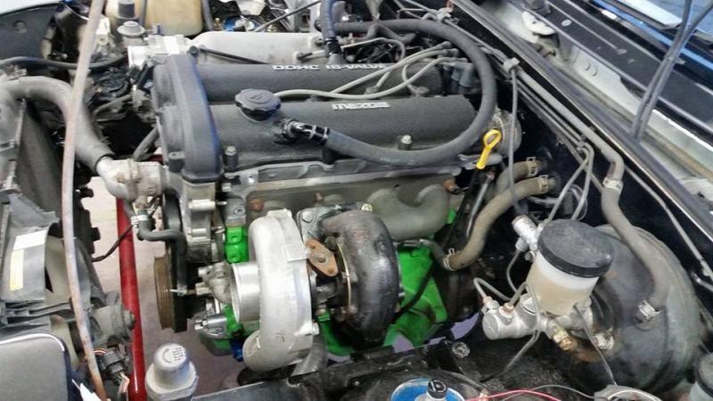

turbo mounted, downpipe is fabbed ( not pictured) mount for wastegate is finalized. catch can and lines were fabbed, tucked somewires. finalized cold side piping( waiting on some couplers for that) and bought wrong style injectors so i need to source some EV1 styles clips for them.
going to need a turbo blankey and wrap the **** out of the DP.
closer, added a few things, need to wrap the dp still and install the vband. wideband in and wired, oil line made and installed, picked up a turbo blanky. wrapped the coolant crossover tube (sits right under the exhaust manifold. waiting on some gaskets.

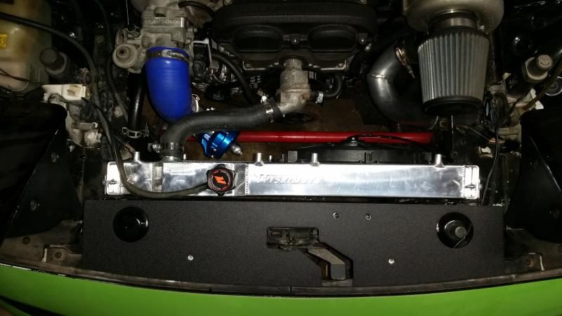

upgraded the stock radiatior to a 57mm aluminum one from mishimoto, had to add a slim fan as the stock one was hitting the bigger sway bar pretty bad. fabbed a radiator upper panel and had it powder coated wrinkle black.

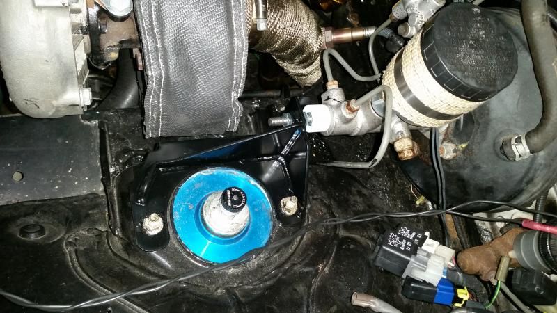

also made a master cylinder brace, as these cars have pretty bad firewall flex
