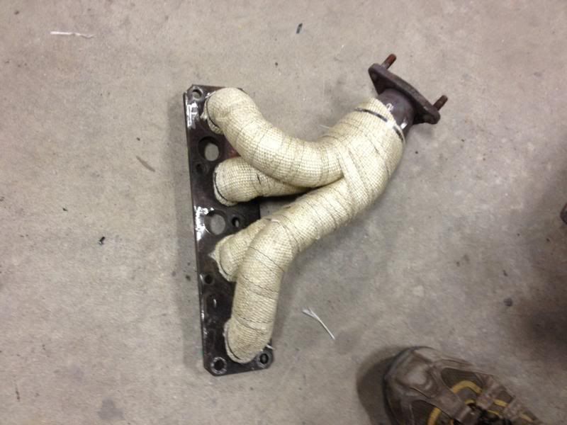

cut the heat shield mounts off and gave header wrap a shot, not terrible for my first attempt

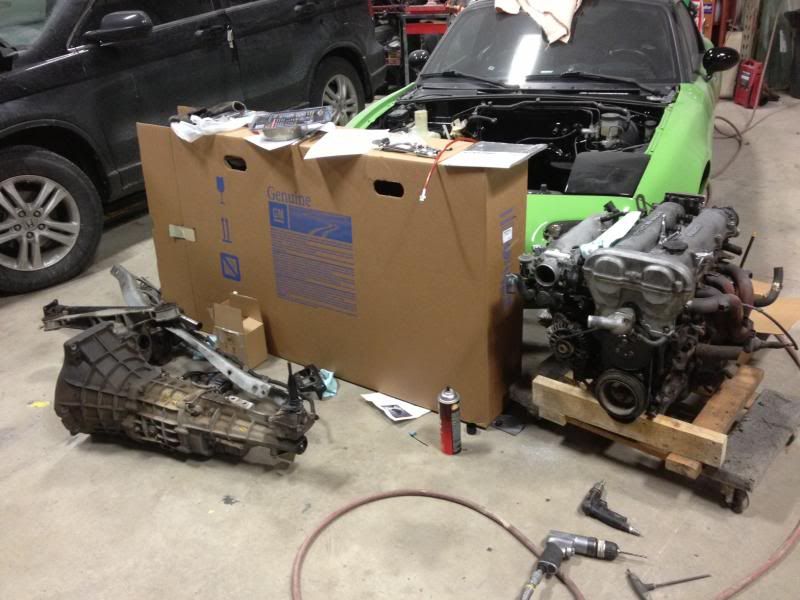

my cluster of crap 95 BP motor, and anniversary 6speed. couple 649 racing parts in there somewhere

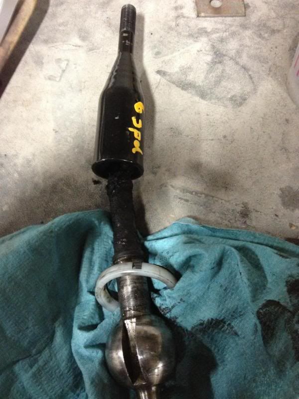

also found this the shifter felt floppy as ****, pulled apart to find out it seperated. no biggie modified my 5spd one for the 6spd tranny
not the prettiest install but it works, next is to get the megasquirt installed after i break the clutch in and what not. then ITB time
