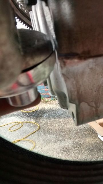

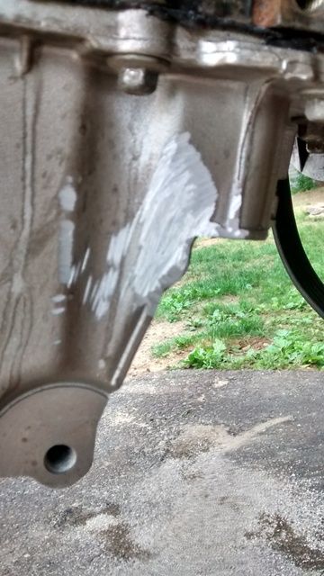

I had to use the ZZP spacer and grind the adapter as well. Tight fit.
