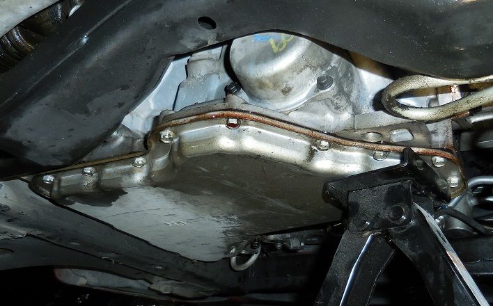

good lord WTF is a jack stand doing under the pan? get that out of there. the trans mount will hold that side up.
looks like you bent the pan and caused a leak.
It's not a jack stand, it's a scissor jack to support the side of the trans Billy's instructions said to support.
I only had it "kiss" the bottom, so I am quite sure it wasn't enough to bend the pan. I took a closer look, and the leak is higher than the pan anyway, I might have wiggled something loose when separating the engine.
I chose the scissor jack so that it stayed at a constant height, since my hydraulic jack doesn't hold so well.
i just put the jack under the tail shaft, pass side and let it hang, either way its likely the cause of the leak, it looks like two wet spots on the pan, above the jack and the round part of the pan. the bolts wet and dripping off it.
I think I found out what caused the trans oil leak, but I didn't find out until we put in the new engine.
After bolting in the new engine to the transmission, I noticed a gap behind where the engine to diff bracket gets bolted.
I suspect the diff bolts serve two purposes, one to seal the end if the diff, and one to fasten to the bracket? Once the bracket was wrenched back into place, I cleaned up the floor with kitty litter, cleaned off the trans pan, came back a couple of hours later, and it is dry as a bone.
For others swapping engines, I suggest putting back the bracket's diff side bolts sans bracket, unless you want to oil your garage floor with tranny oil.
