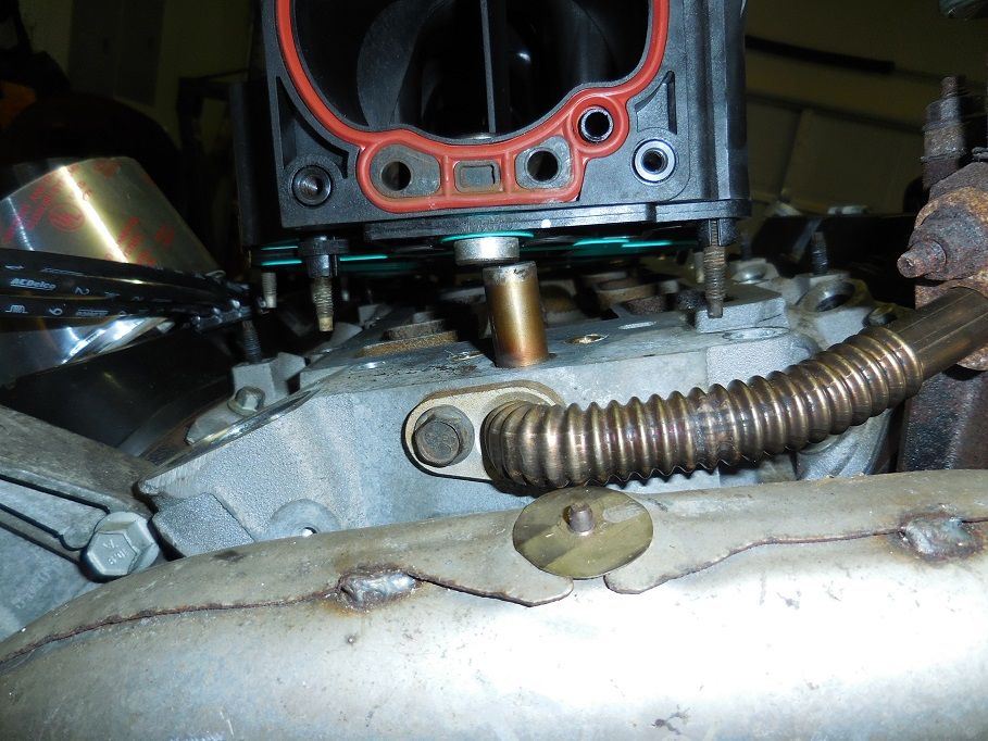

one of these things is not like the other. The OD on the manifold tube = 16mm which is the same as the ID on the plenum's tube. Should I just cut the plenum's flush with the bottom of the plenum, and use an emery cloth to reduce the size of the manifold's tube so that it fits inside the plenum's tube? Any other suggestions?
thats the egr tube. you should be able to remove it and swap in the one from the l36 lim, or just swap the lim from the old engine.
FYI, I cut the plenum EGR tube almost, but not quite flush with the L36 intake plenum, used a plumbing brass brush to clean out the inside of it, thoroughly cleaned out the plenum of cutting debris, and then it slid perfectly over the L26 LIM EGR tube.
The key here is to trim the plenum tube so that the gasket is thicker then the stub left after the cut.
