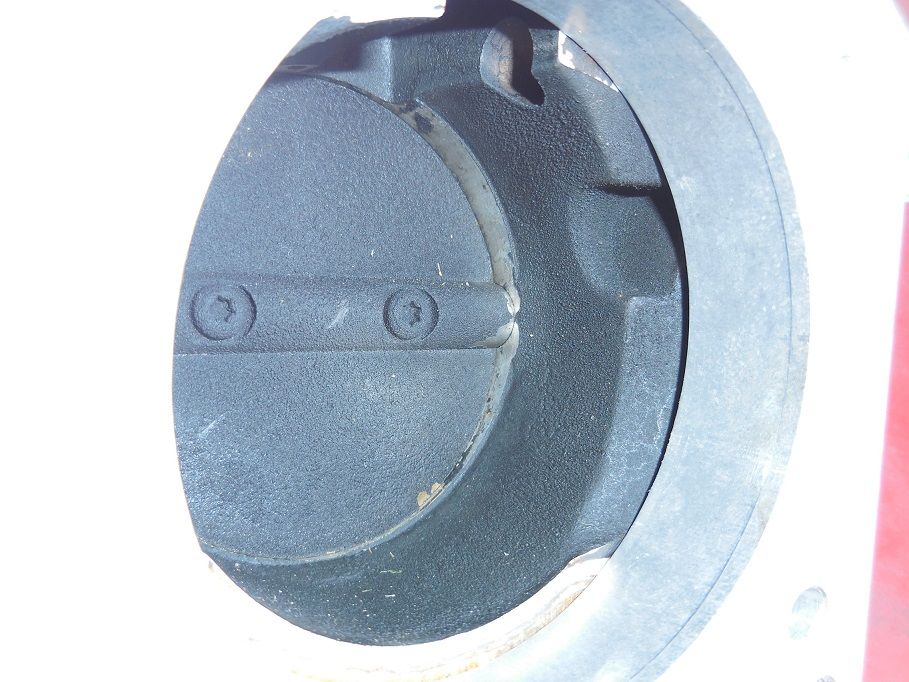

Have you test fitted the TB adapter? I'm just wondering since the L36 TB has a butterfly shaped inlet, compared to every other 3800 lol
If there's a lip anywhere on the inside, it could cause turbulence and mess with the airflow into the intake... Don't know what problems that would cause, but I imagine that at full throttle something wouldn't act right. Plus in the interest of performance, it would be cringe-worthy.
I'm sure glad you posted that, you are correct about the interference.
With this issue, and the other adaptations necessary, I am leaning towards keeping the L36 intake plenum, it was recently replaced and in brand new condition, and should bolt right on. The only issue may be the length of the EGR tube on the LIM, but I can measure and replace if needed, or just keep the L36 LIM, decisions decisions...
