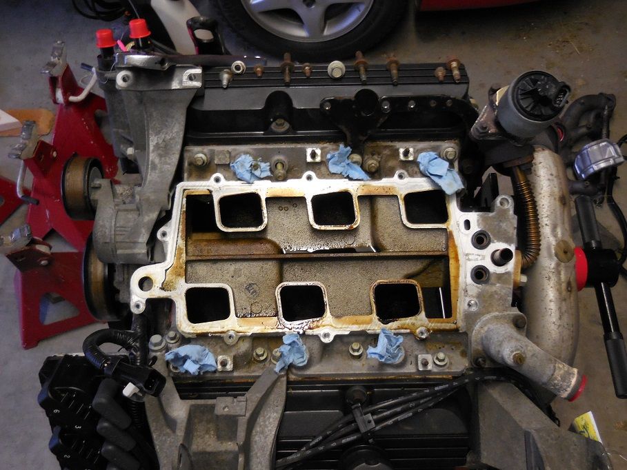

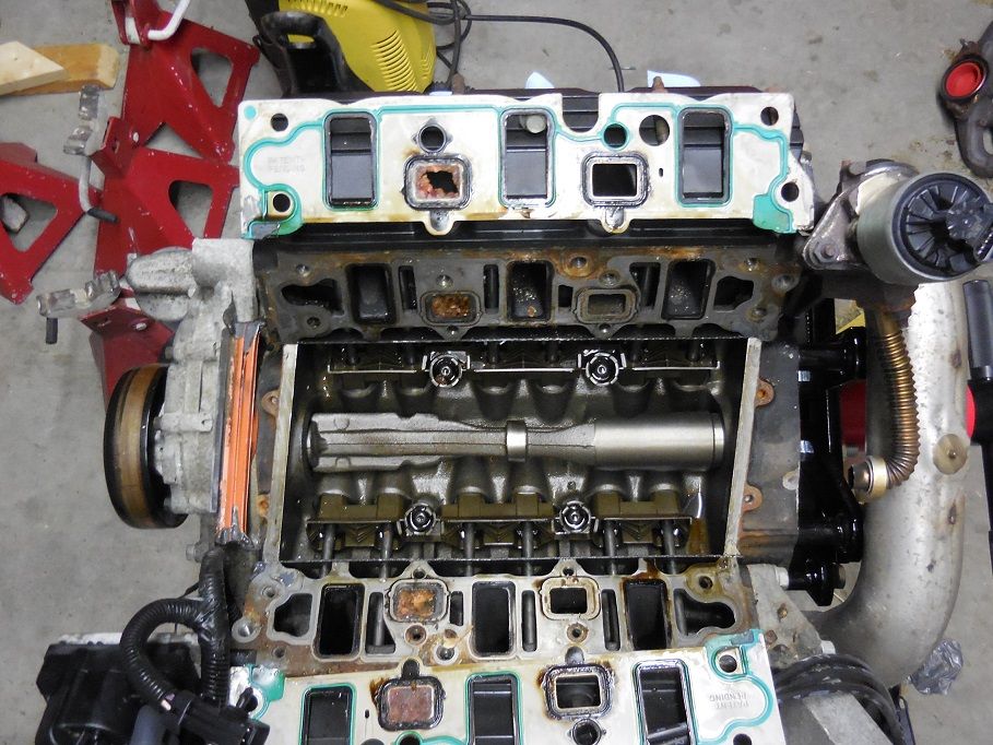

just clean that crap out the two ports, they all have that, thanks to dex coolant sludge.
lay some rags in the valley so none of that crap gets inside the engine.
thats a damn super clean engine inside. you got a winner by looks so far.

Dexcool is different than 8 years ago when it was still in the grand prix's and other GM cars, it's just as safe/good as any other coolant. Keeping the air out of any coolant system is still the key to long life.
Universal gold and green coolant are might be cheaper than dexcool and I use that stuff if I ever want to swap it out.
thanks guys, this set me at ease - I was wondering if I had a 500lb paper weight.
I will make sure to flush, plugging up the passages first as recommended.

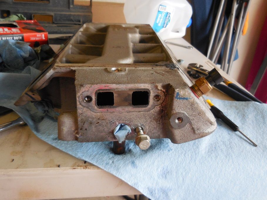

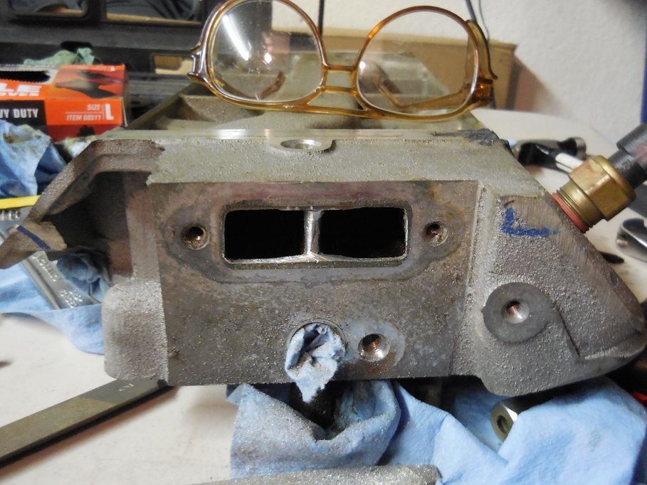

I used a dremel tool to hog out the coolant passage, as long as you bring those inside edges down to the center support that will be enough. The new intake gasket set should have a new rectangular gasket for that cover plate as well.
and don't feel bad about the dexcool crap. I've still got some sludge, and I did my switch over to green over 3 years and 2 coolant exchanges ago. lol
nice work. just wash it out real good after all the drilling tapping and cutting. you dont want any metal bits left behind.

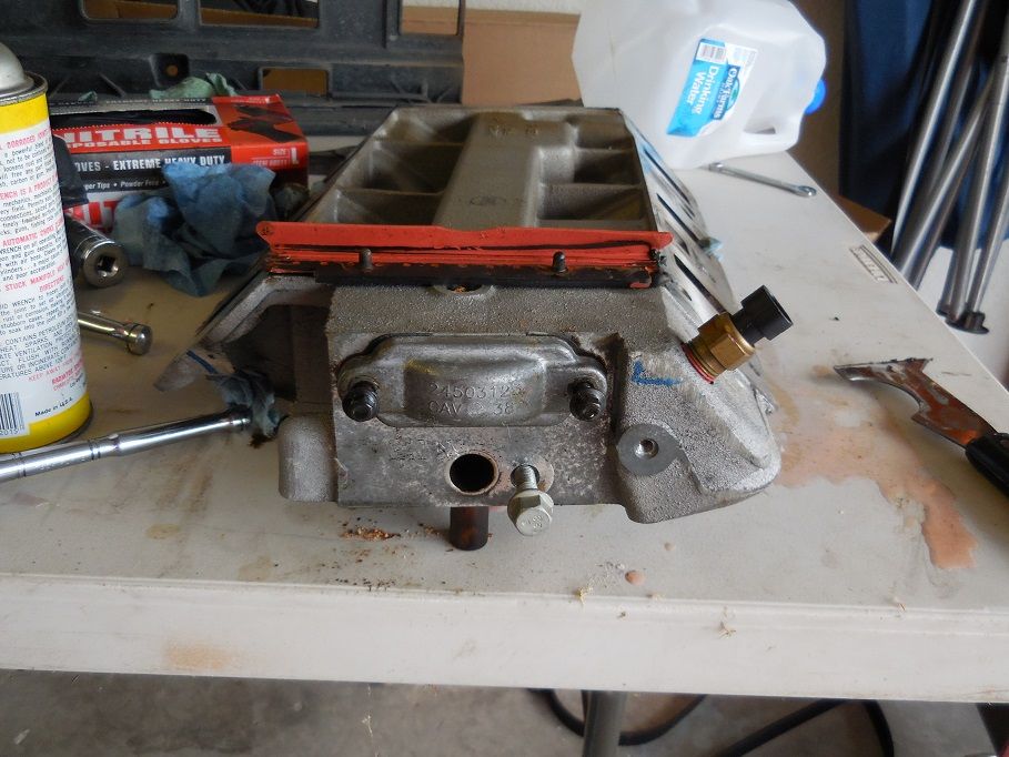

For the drilling/tapping/plugging mod, I'd like some advise for approaching this project...
I'm thinking about using my drill press, find a bit that fits snugly in existing hole and clamp the LIM to position it exactly where it needs to be, remove "snug" bit and replace with drilling bit and bore out hole to 1/4 npt tapp spec. Then follow the advice given here to very carefully tap with lots of test fitting of plug. Sound good?
That sounds like a very precise way of doing it, and it should work perfectly.
