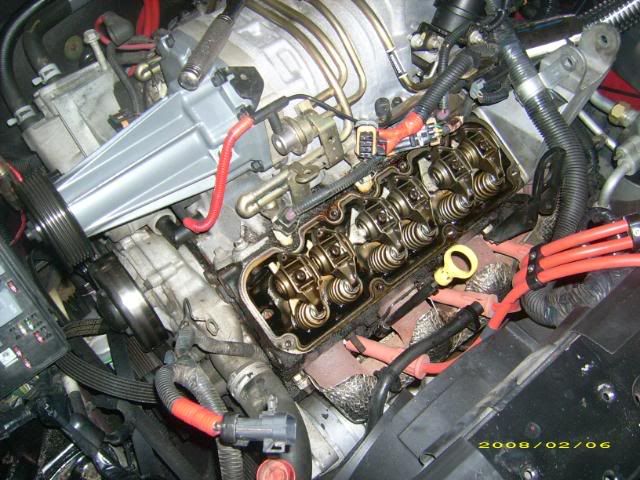

Any logical steps in approaching the removal of the rear vc, once I tilt the engine a bit forward...The front took me about five hours...I was documenting all the steps so as not to forget anything and at the same time, I can help others with details (i.e., socket sizes etc...)
Disconnect the battery
remove the back plug wires to move them out of the way
remove the alternator and the black alternator bar (most do not put the bar back on)
Loosen the alternator bracket but don't remove the bolts
remove the MAP bracket.
I removed my engine bracket(s) at this time and put them on the shelf.
I think that this should give you the access you need.
Now would be a good time to replace the coolant elbow though. If you do this, go ahead and remove the alternator bracket as it will make removal and installation of the VC somewhat easier.

Why shouldnt I remove the alt bracket bolts? I have mine out sitting on my workbench. Was that bad?
Unless you are planning on replacing the elbows, it's quicker and less messy to leave the alternator bracket on and just lift it enough that the vc can be removed. There is absolutley nothing wrong with how you did it.:)
Edit; Are you saying you only removed the bolts and have them on the bench? That is fine too.
Now that I think about it I may have removed the bolts and just left the bracket held in place by the coolant elbows.

What is MAF?....Why is it a good idea to remove the coolant elbow?...That's the 90 degree elbow just to the right of the alternator?....Right?

Manifold Absolute Pressure sensor. If you look at your rear valve cover there is small horsehoe squared off metal bracket that holds the MAP sensor. I believe this may be in the way of you being able to remove the valve cover. The MAP is a black plastic rectangle with an electrical conenctor and a vacuum line that conenct to the underneath. I believe the same bracket holds the evap solenoid.
If it were me I would remove the alternator bracket and replace the coolant elbow while you are doing all of this. Yes it is the 90* black elbow. If installing a new one, be sure to put a little vasoline on the orings so they slide in easily and don't pinch or bind.
