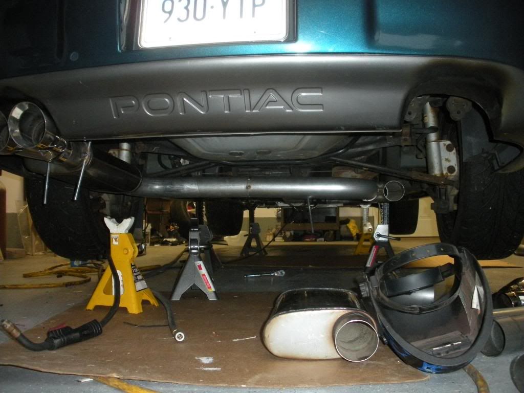

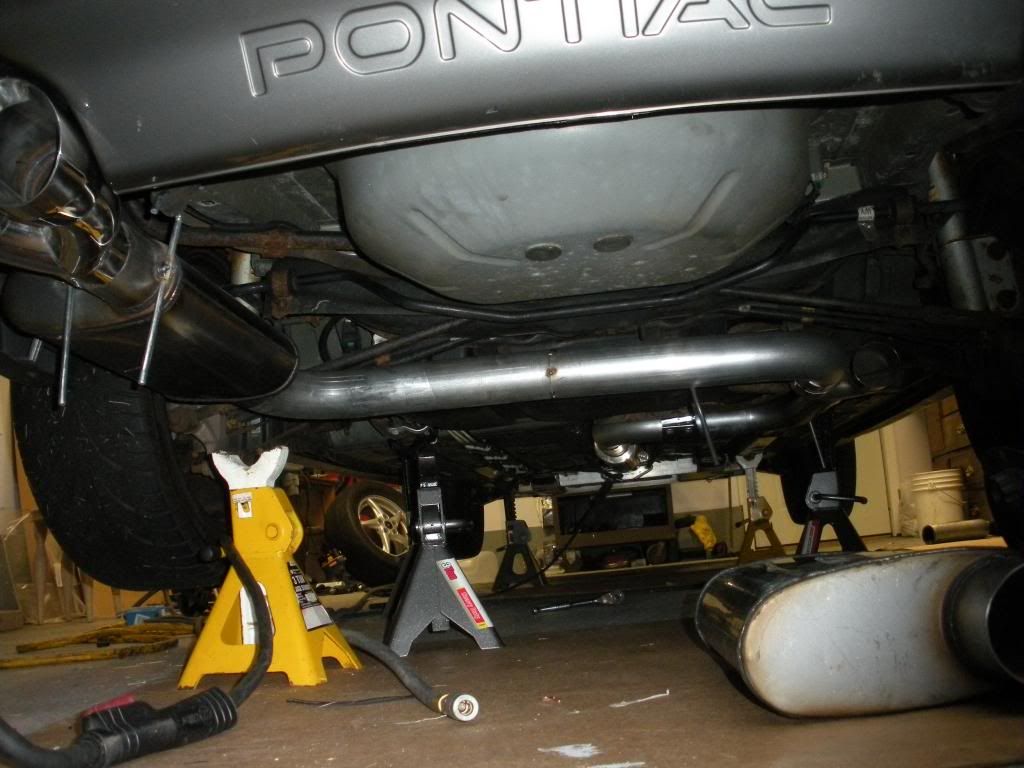

Got some exhaust work done, unfortunately without the help of my buddy's lift :/ Almost done mocking it up. Just the pass side from the Y left. Then drop it and weld it up fully. so close............
took it out for a short test drive with the new exhaust tonight... Its so quiet. almost disappointingly quiet. So used to the flowmasters rumbling. But nonetheless, it def sounds good! Also was monitoring under blower IAT's @ 15psi.... only 118* The dual ic's are def working great!
Sleeper.
Exhaust is done. All mounted up. NEED CUTOUT lol what a difference it makes having an exhaust on the car. Thinking QTP oval cutout to side dump.

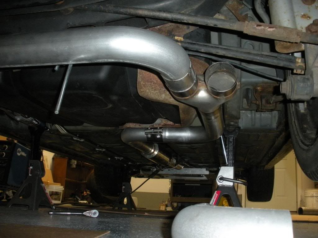

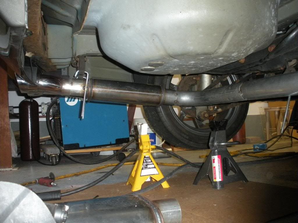

is that cat back a kit? or custom?
looks sweet. ive yet to see one like that.
Its custom. i bought a 3" mandrel bent builders kit online for 160 bucks, picked up a y, resonator and 2 mufflers and built it. 3 inch and no smaller from turbo to tips.
