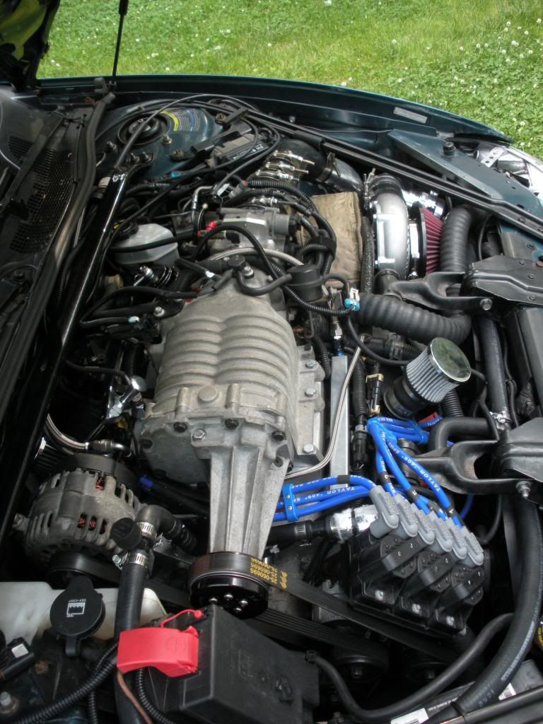

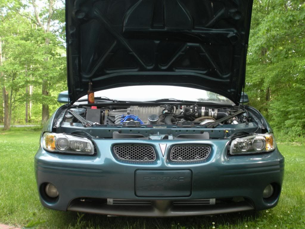

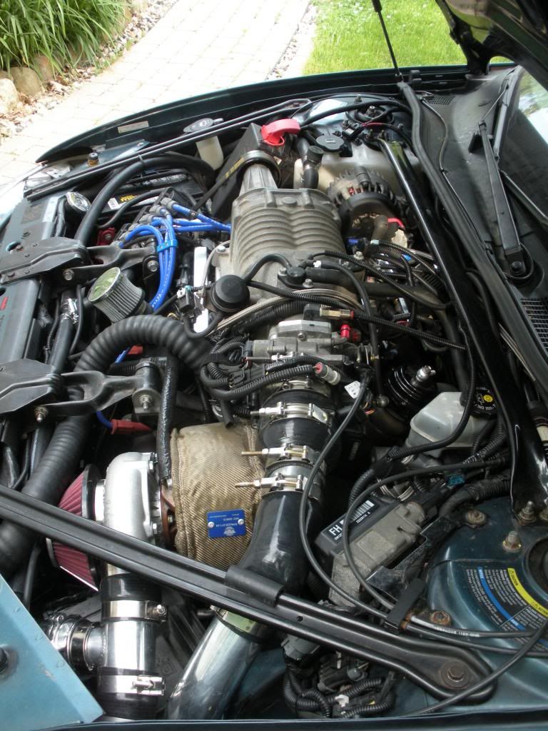

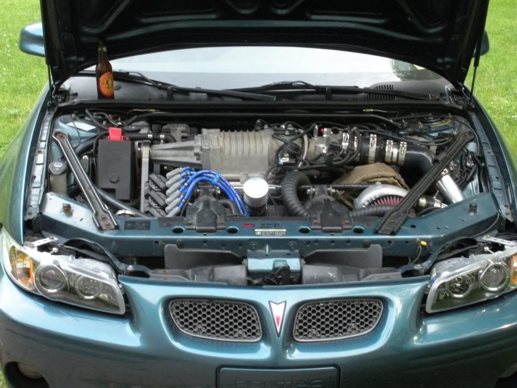

more pics cuz she's a whore. A dirty whore at the moment LOL
