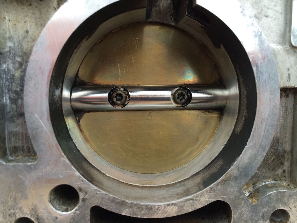

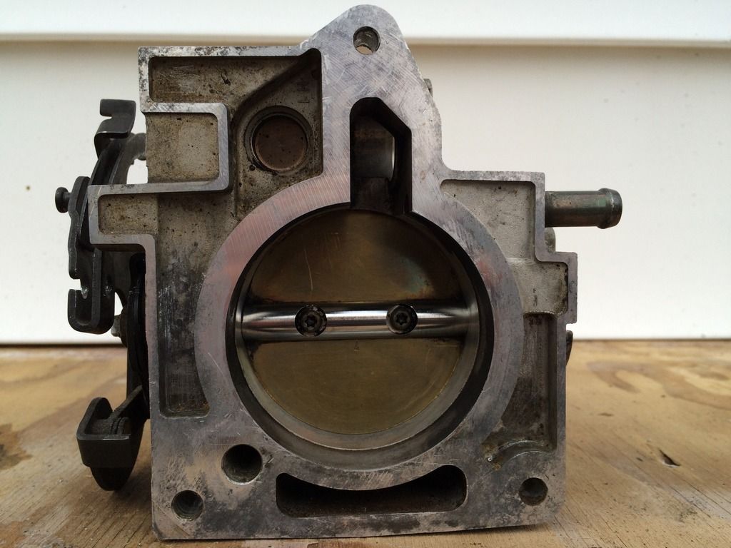

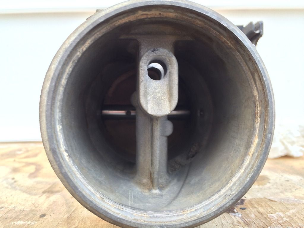

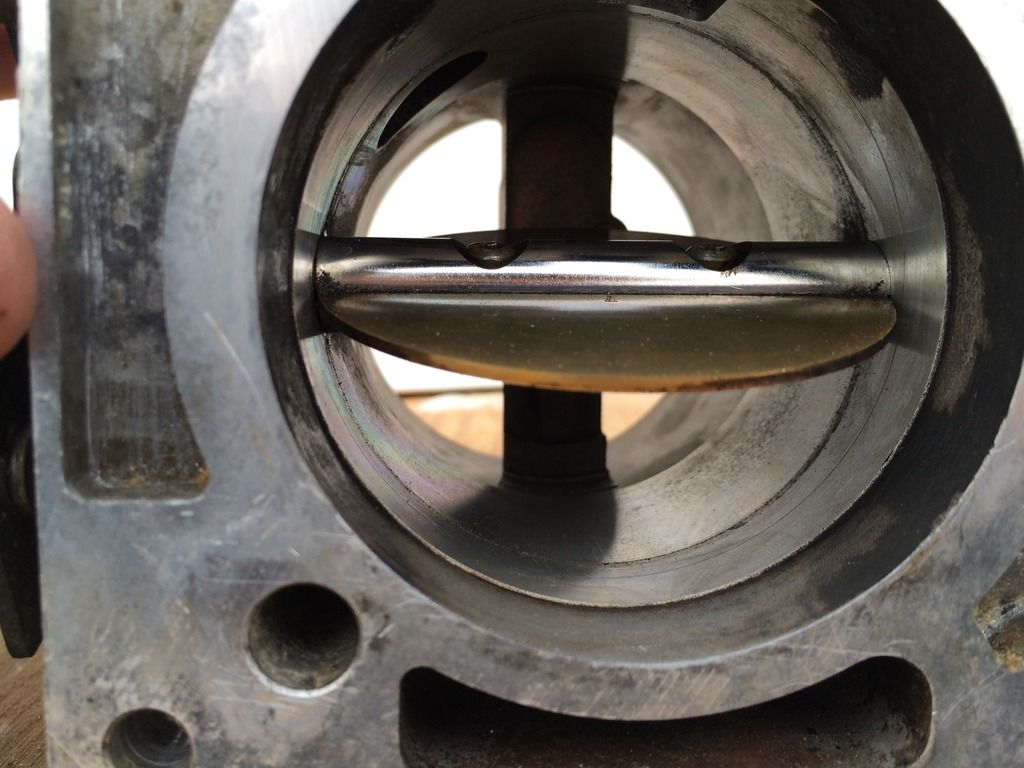

Not sure why GM decided to put an entire stem right in the opening of the TB. Such and air restriction.
But I got it all clean and was able to free it up!
Re: Subway's GT: Top Swap Parts Are In
so the butter fly moves now? you soak it, or just f with it till if moved?
Just sprayed a lot of brake clean in it and let it soak for a minute or two, and took a pliers with rubber ends and hit the valve while pushing on the spring thing on the outside and it eventually broke loose.

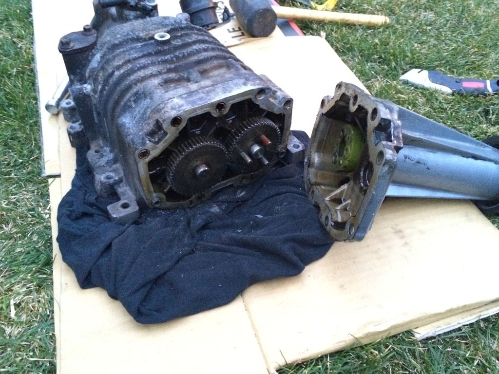

Drained the oil out of the S/C, was gonna separate the snout, but ran out of time. I'll do that this weekend.
Also cleaned more of the TB, scraped the bottom of the S/C clean, and blew compressed air everywhere to clean it all. Mainly in coolant ports and such.

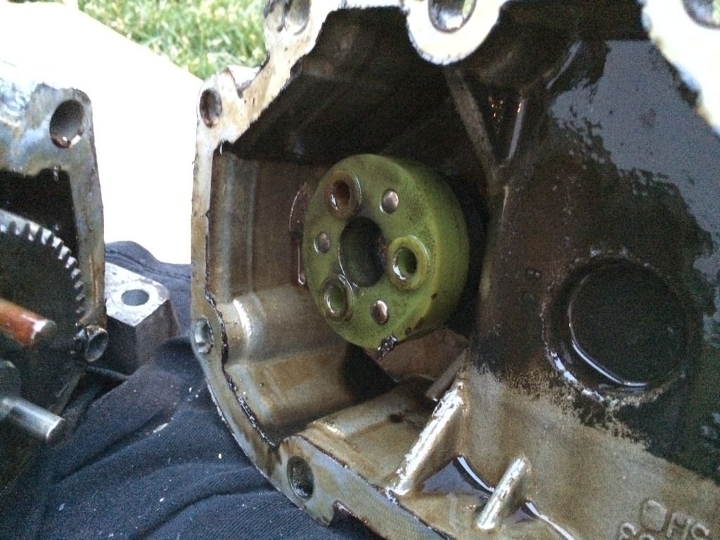

Took some effort, but it's off. Someone has been in here before, which makes sense as I was told it has been rebuilt.
Nifty, never seen the inside of one. So, what do you look at to tell what's been rebuilt? (noob here, lol)
I would assume a true rebuild has new bearings pressed in the case and greased. Probably new snout seals / bearings
Also the coupler is replaced.
What is shocking is there is a zzp coupler installed (green) and apparently it's already shot. OP said there is a lot of play in it.
I've seen OEM couplers tight as can be with over 120k miles on them.
Maybe ill go back to ordering OEM ones
Interesting. Car it came off of had 180k, a 3.4" and no supporting mods (unless you count straight-piped with huge rice-y muffs out back and a K&N CAI)...., so ya never know. It felt more solid than my 200k+ S/C, I guess I just did what I was told and took a video and it seemed good, lol.
But, like, how can you tell the coupler is shot?
When you jerk the pulley back and forth by hand, you shouldn't feel any play.
not really a big deal at all. Changing a coupler is just as easy as changing your plugs and oil.
Literally place your hand on the pulley and snap it back and forth. You'll know
