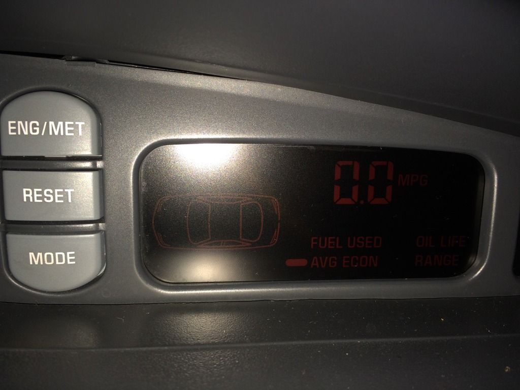

So has begun the experiment... Filled the car up until the pump clicked. Didn't go anymore than that. But before I filled up, I added the Gumout All in One Fuel System Cleaner, just to see if it helps. I reset the trip mileage scroll thing, reset the fuel used, and reset the Avg. MPG. Over the course of this experiment, I will be resetting the Avg. MPG each day so it reads each day and doesn't settle out. I will then average out the Avg. MPG.

Everything is reset.

So with all that being said, lets start logging all the data.
Day 1
Mileage: 1.55mi
Avg. MPG: 20.0mpg
All city driving

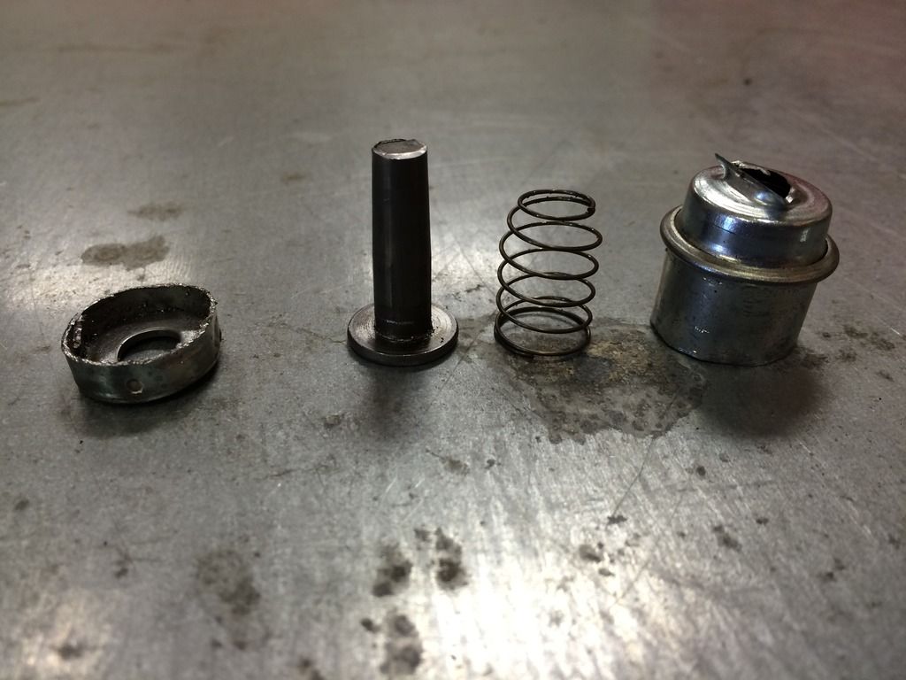

Changed my PCV valve and wanted to see what it consisted of. Super simple design.
