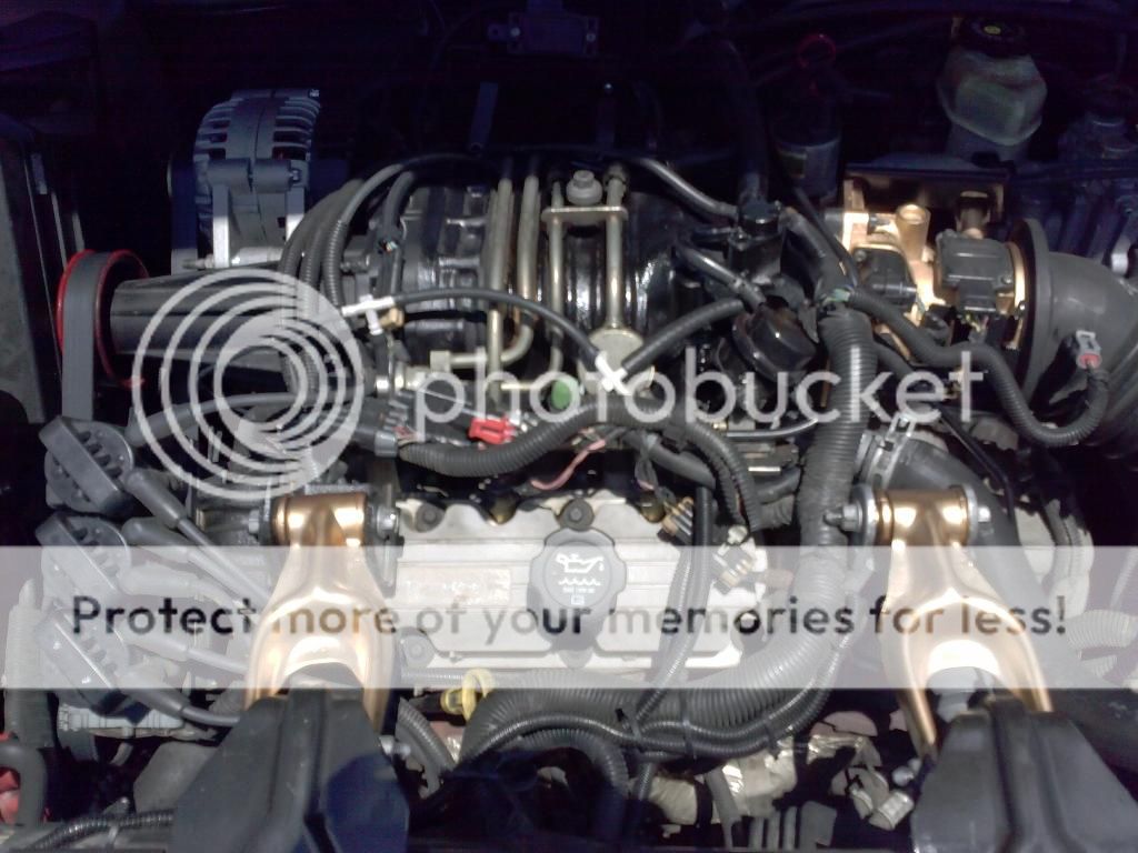

Um no it was so bent already and it just would no longer seal my injector regardless of being bent over and over. Lol

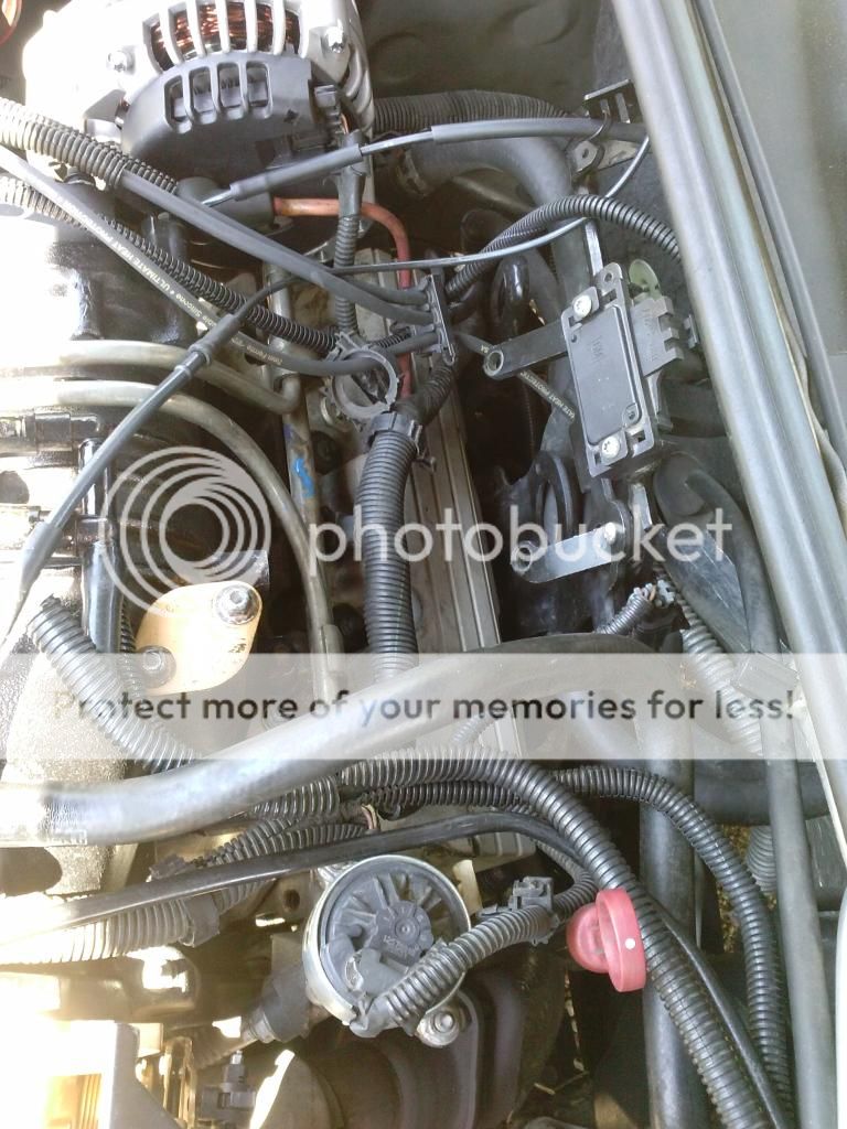

wheres your evap purge solenoid? i see the fat hose off the tb but loose it.
it should be back here, next to the map thats not mounted. not even sure i se a vac line going to the map either????
and whats the red plug on the front here? is that the evap?
ok, if that red plugged part is the evap, where the other line from it? thats a huge vac leak right there, that solenoid gets a line to both sides, one side comes from the tb, the other line runs to the gas tank.
They are both plugged in correctly. The line that goes to the throttle body is there and so is. The line that goes to the tank. Reread how i routed my lines. I followed both of your guys instructions. It hooked up correctly with the vacuum lines its just mess the way it is.
Also its gotten worse with the hesitation/ stutter, when attempting to floor it i get to 4500 rpms when it shifts. And the stutter happens at anything above 3k rpms. No one answered my question as to whether i should regap my plugs?. And when that hesitation happens it feels more of like a cut off because boy does that thing jerk you around. I literally feel it cut off and then resume cut off and then resume. But sometimes its at a quicker pace and sometimes it's at a slower pace
