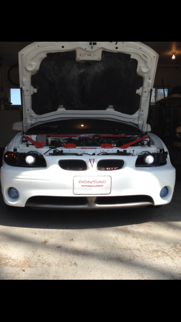

Palm tree car got a new car

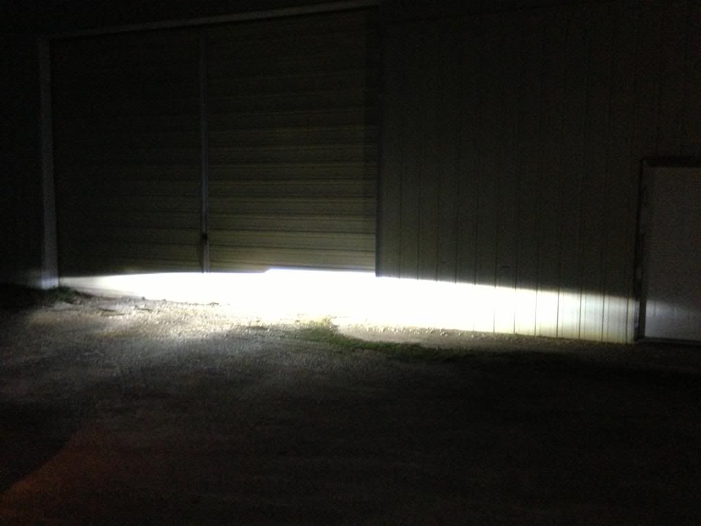

yeah cam i farthest i was able to get away was about 30 ish feet but it was on a hill.
Re: Palm tree retros making me angry
Yeah, definitely go somewhere you can be further away from a flat wall. Because, from here, it looks like either your shields or bulb placement is tweaked - it shouldn't bow like that so much. Also, not sure if it's just the picture or not, but your passenger side looks wayyy brighter than your driver side. It looks like your driver side hotspot is completely missing. This could also be due to bulb placement.
Other than that, the housings looks sick with the white. Good work.

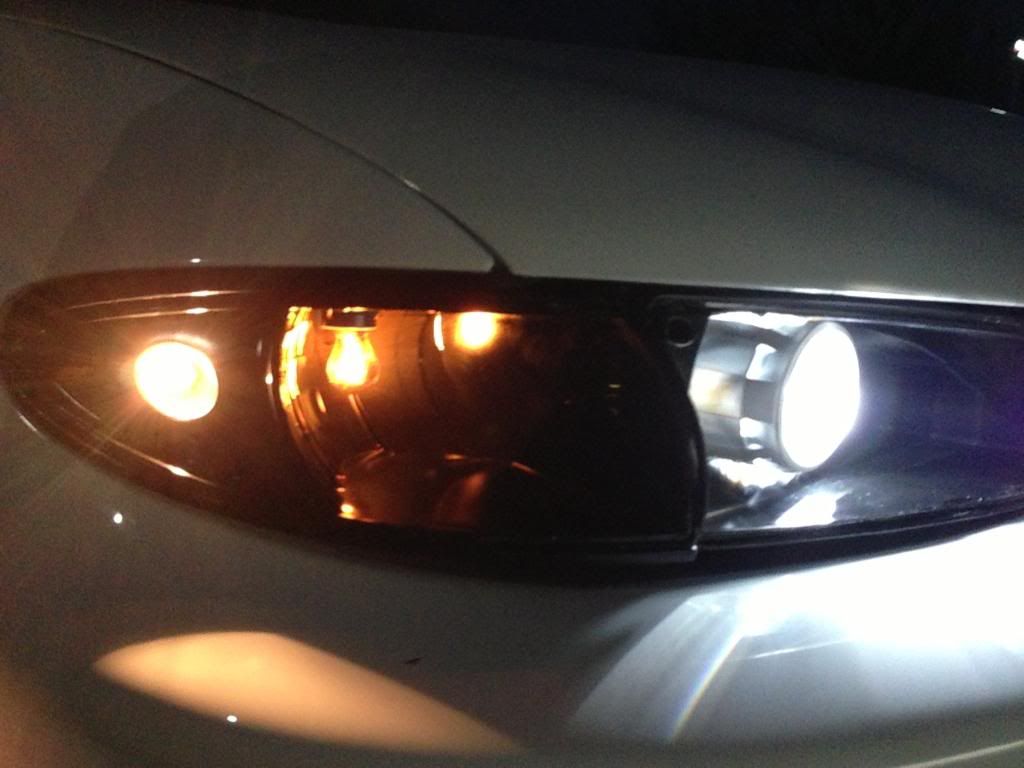

so they are coming along fine now they are ready to get sealed up. the one side is almost perfectly straight and the other side is slightly crooked and i cant turn it all so it will be that way. I bought a new corner marker from a member yesterday so hopefully that will get here soon

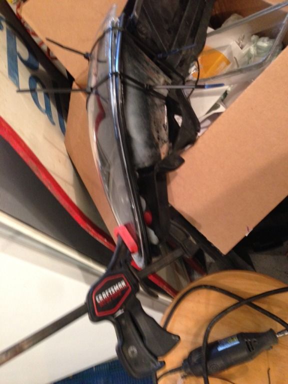

tried to reseal the headlights today testing out my awesome clamp job
