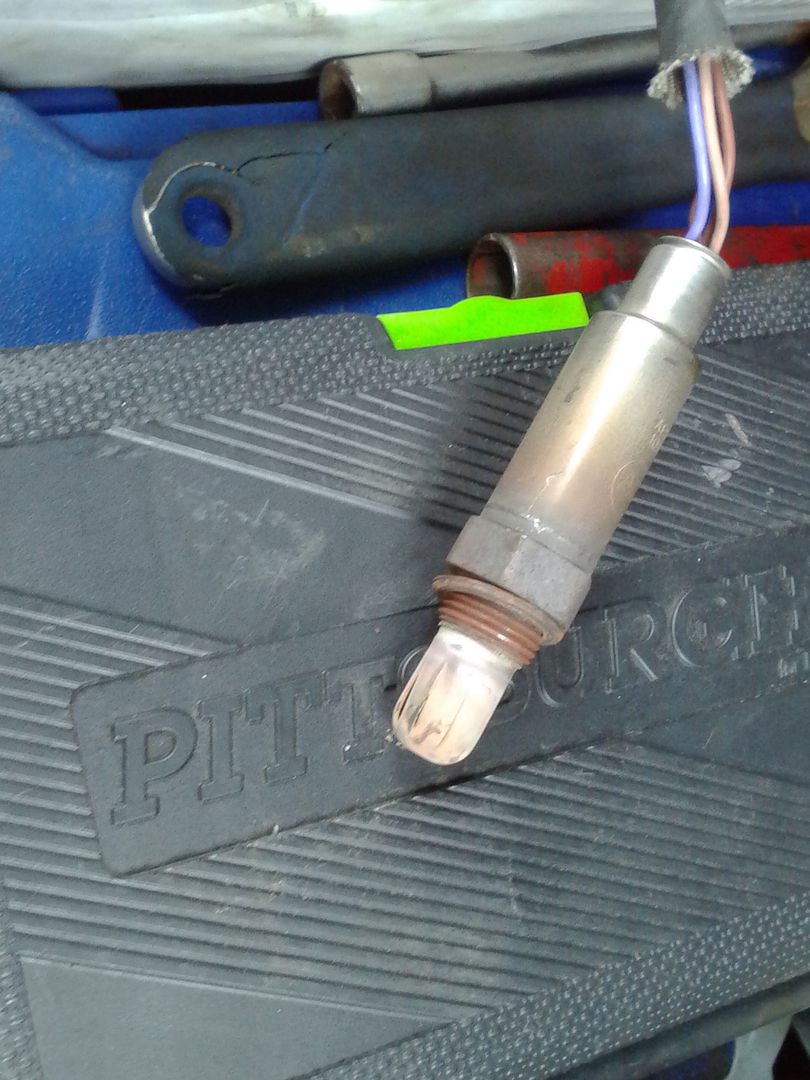

I'm fairly sure the part that plugs into the exhaust is different, but I think I have a downstream 02 in my upstream slot... I think this because of the picture of the upstream vs the picture of the downstream plugs on the Autozone webpage. Also, I pulled one out of the rear exhaust manifold from one of my 2 engines and it was a longish white looking thing that went into the exhaust, kinda looked like a new LED light thing. And the 02 from my other exhaust manifold was shorter and fatter and had little angled slits in it. I'll nab a pic of the second one.
Also, the fuses inside the car aren't numbered?
02 from second exhaust manifold.
Sent from my SM-N900P using Tapatalk
theres different styles. i pulled this up stream o2 out of my manifold, its from 02 or older ive found out, they stopped making it years ago.
my new one looks like the barrel of a tommy gun.
Alrighty. Thats what one of my upstream ones look like from my 99.
My upstream sensor from my 04 L67 from the Impala looks as you explained the barrel of a tommy gun =P
