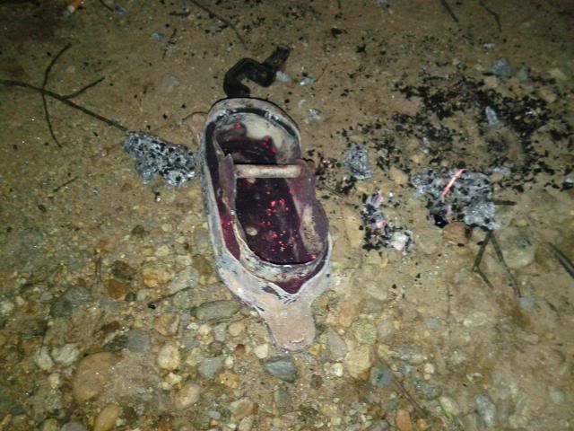

Re: Gins 04 Comp G

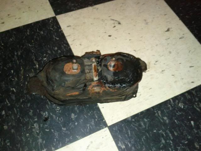

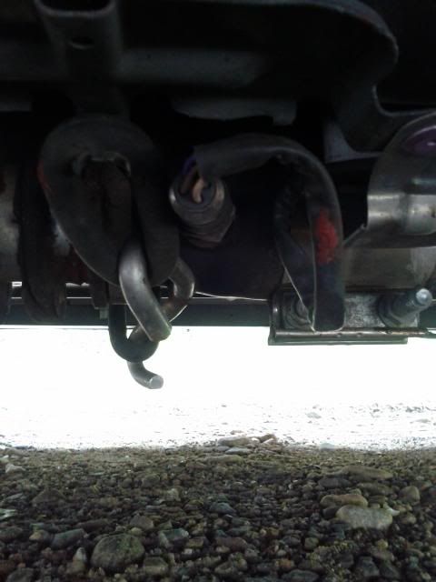

lucky you see how your 02 is right before you exhaust hangar my 02 goes right in between the rubber 0 ring what a bad spot whats so bad about the hydraulic fluid in the mounts not sure if I should replace my mounts or not engine doesn't seem to move since I put the upper polys in

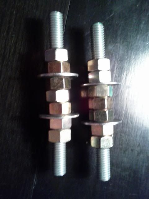

Re: Gins 04 Comp G
Yea but I have polyurethane mounts in the dog bones they don't .move ill see what's up woth the bottoms tomorrow

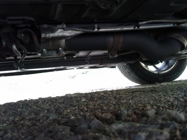

Sounds Good...that was a nice little drive.
Wish I could get a tune from one of the big dogs......with-out having to drive to mars.
Car is a little violent sounding, do you have a res?
Re: Gins 04 Comp G
car has stock exhaust except headers
Re: Gins 04 Comp G
Holy jesus....oh yeah &mary.....headers ONLY??.....that sounds more snot bucket than my G with stock mani and SLP/2.5 catback. but this be one devil machine/2013

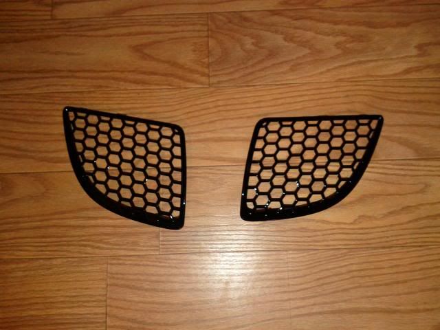

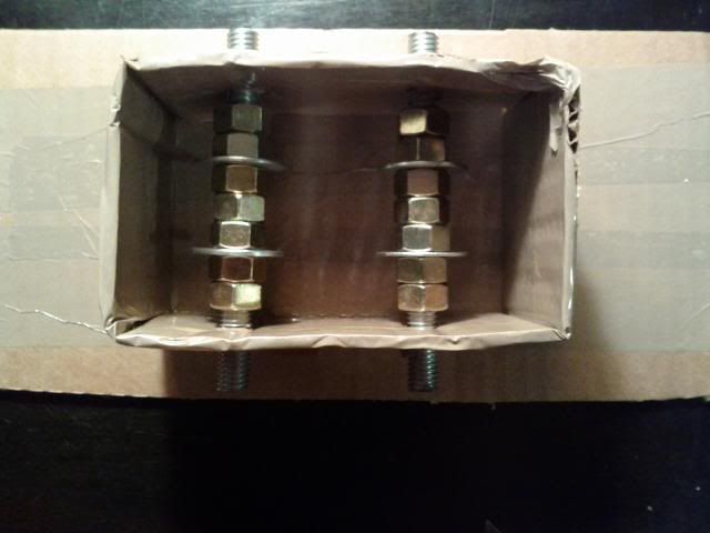

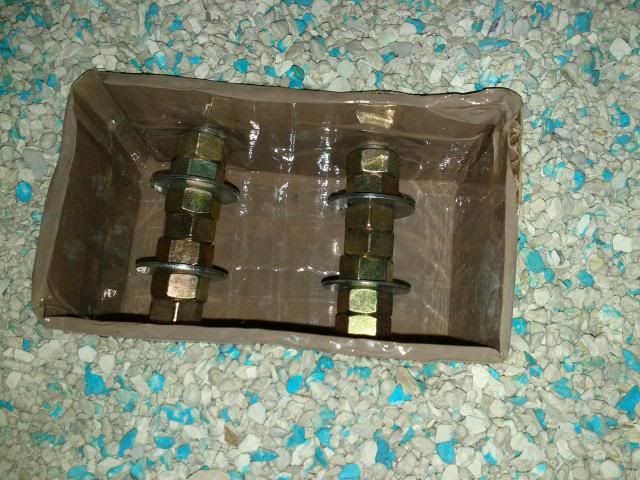

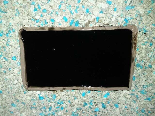

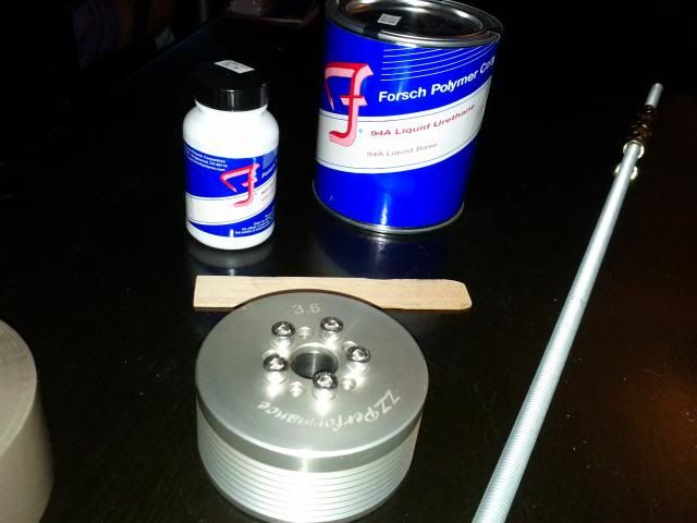

Got some stuff in mail today.
Warning mass pictures inc.

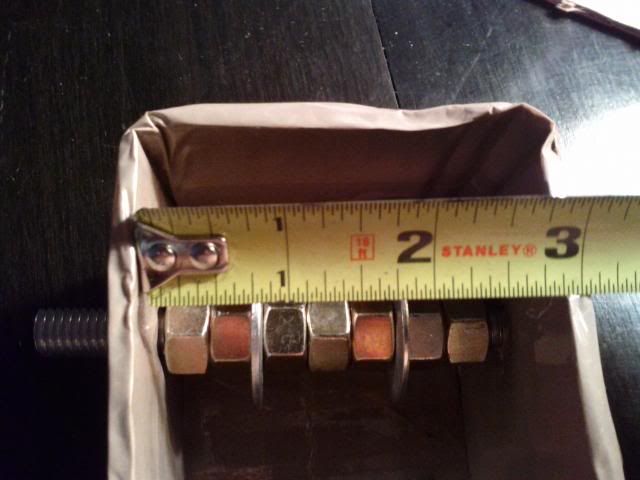

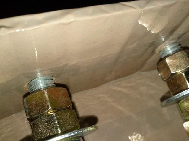

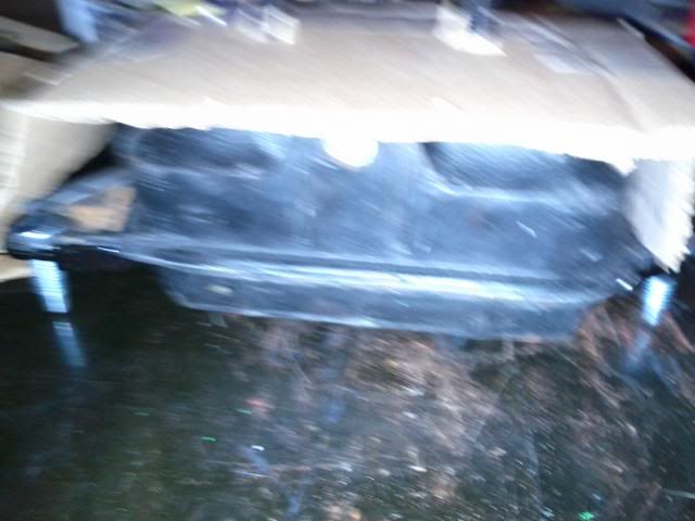

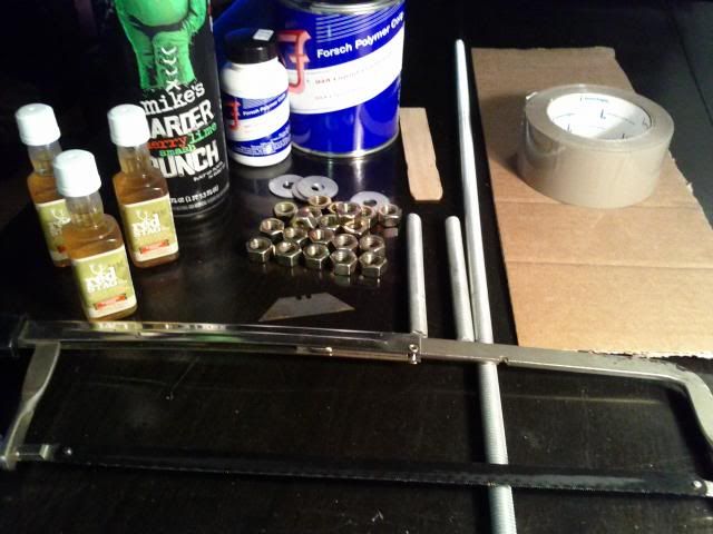

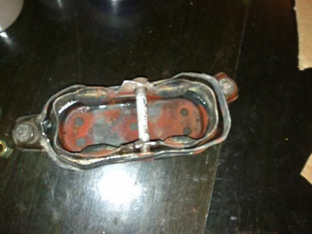

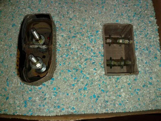

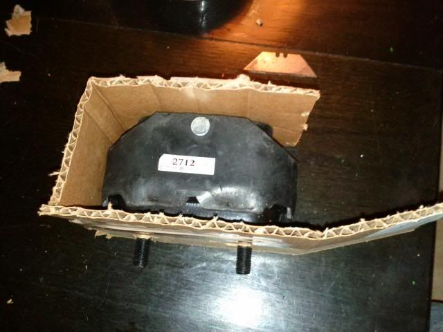

My mounts didnt hold up because i dont think i let them dry long enough so im making my own real polly mounts

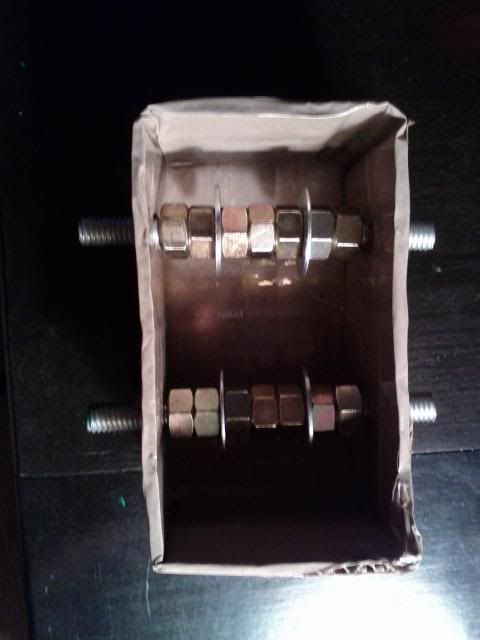

Everything needed for mounts

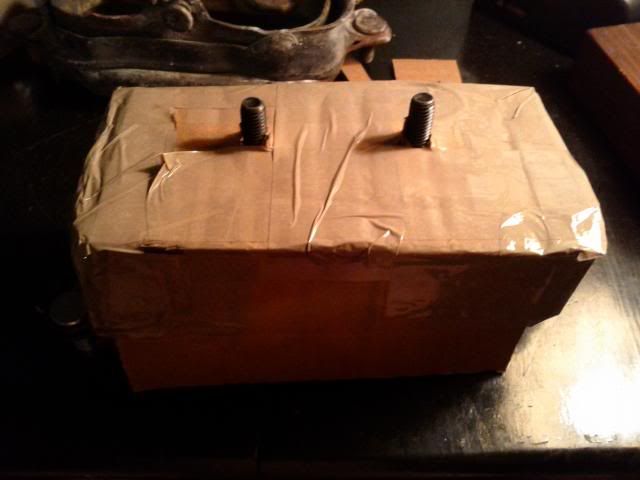

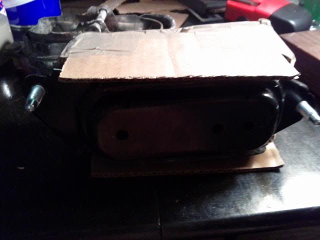

Starting molding
