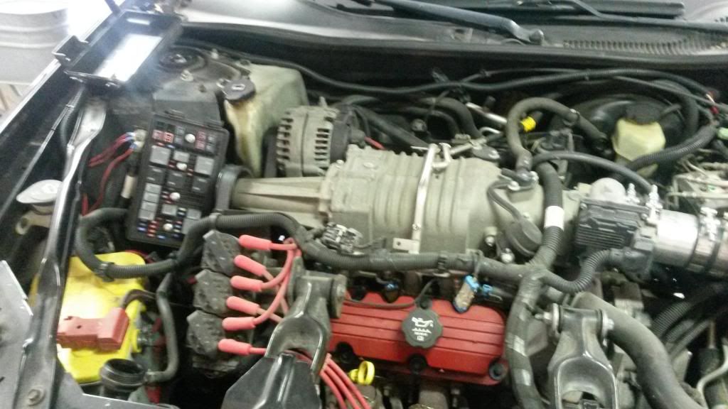

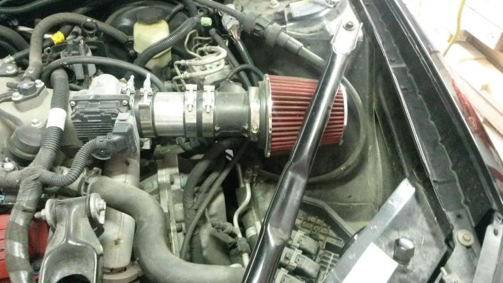

check the plug wires are on right.
and also look for a vac leak. when you take the lim off the chance of a line breaking is always there. seems everyone needs to replace at least one part of line when doing a lim job. spray some carb cleaner around the engine listen for the idle to jump when the lines are sprayed.
