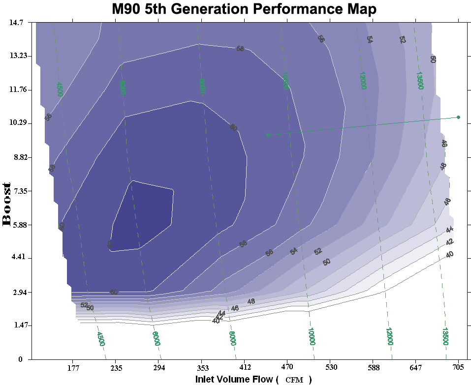

Faith equals hope and I believe science proves everything with that being said Im trying to find the effeciency charts for the M62 vs the M90 gen5.
If your on X pulley on your Gen5 your going to have to spin the M62 a third faster just to equal the volume your at now. And by spinning the M62 a thrid faster you will have a higher outlet temp than what your Gen5 is at right now.
Seriously use your gen5 and meth, nitrous, bigger cam, E85, or IC
At 6000RPM you need 684 m^3/hr of air, for a N/A 3800 engine.
For boosting to a pressure ratio of 1.5 using either supercharger you require 1026 m^3/hr.
A single M62 cannot provide enough flow, according the performance map. Even if you extrapolated outside of the map, the M62 would need to spin closer to 18K RPM.
So obviously you plan to use twin M62's. You now need 513m^3/hr from both of them, and at pr=1.5 they are approx 64% efficient.
The M90 at 1026 m^3/hr is roughly 54% efficient.
Now that we know you are using twin M62's (clearly one M62 is the worst idea known to man), how you will make an intake for both......I do not know.
Also consider the difficulty in routing a belt to two of these, and the higher losses incurred from two loaded pulleys and unknown idlers.
Two M62 will also weigh more than one M90.
I think the 10% efficiency increase is not worth it.

This is why I'm doing it...
3.2 pulley from 4100-6300rpm
2.9 pulley from 4100-6300rpm
