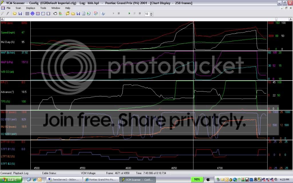

Best I can find right now. Thats on a 3.25 pulley stock l67 injectors 12.3 afr with a lean out issue and yes injector drop off. so I droped 2-3 degrees of timing to be safe.I was trying to figure out, and pulled my 60's out to see if they were the issue(I was runing e85 about 8 months ago). If your really interested I have over 200 scans on my home CP im at work. Anyways heres the car and mod list http://www.grandprixforums.net/green-pos-2001-gt-42587.html oh and on a 3.25 I run 10ish PSI depending on temp

You have an intercooler... How is that at all comparable to me or close to what I asked?

Not really just saying the TVS is kinda pointless until the tune and injector issue is fixed 1st.
