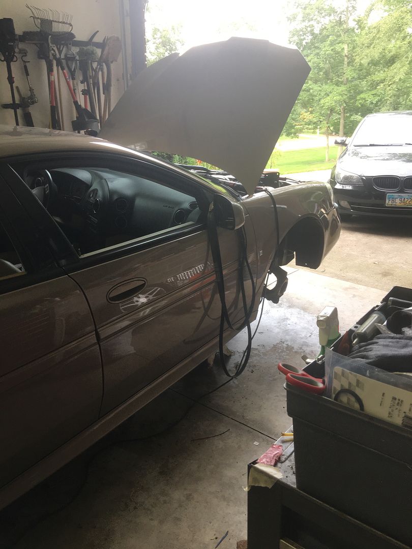

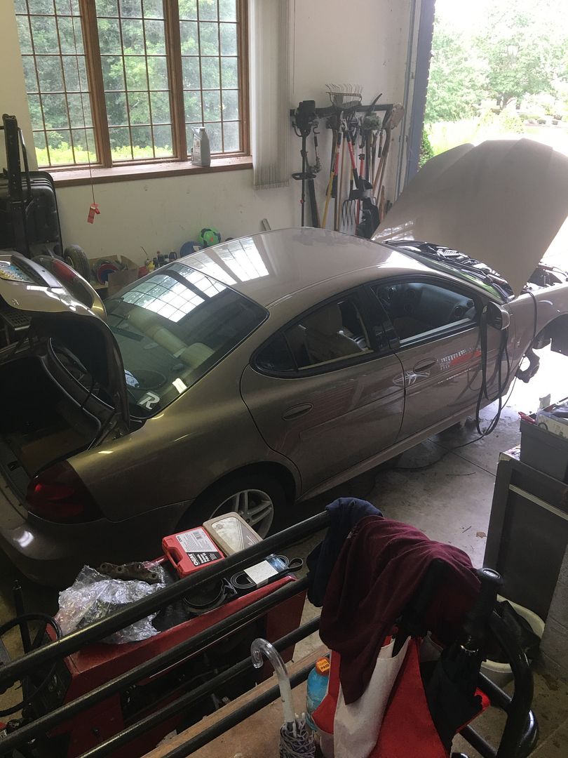

For your enjoyment, my daily update
First some pics of the beast

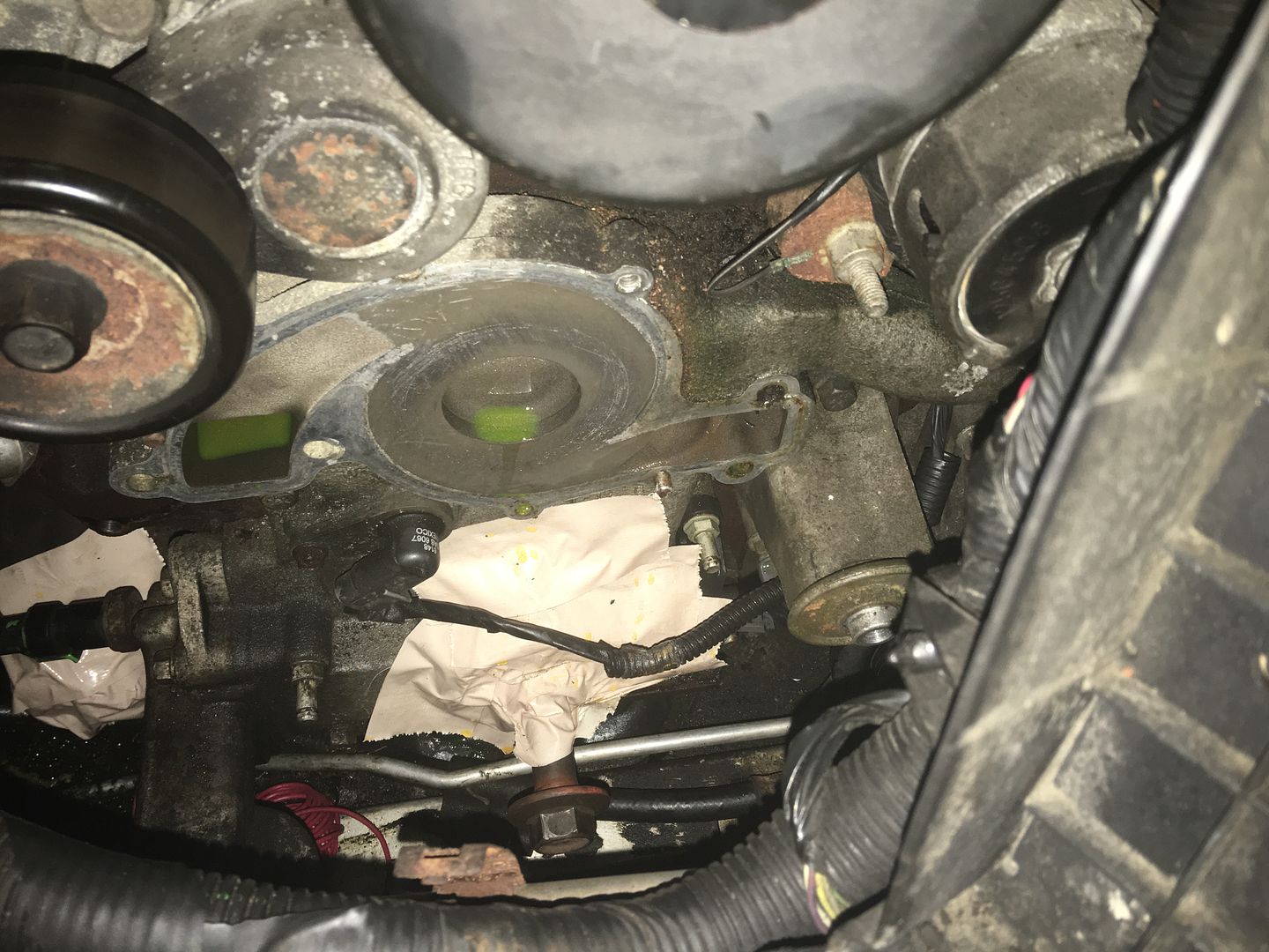

today removed water pump

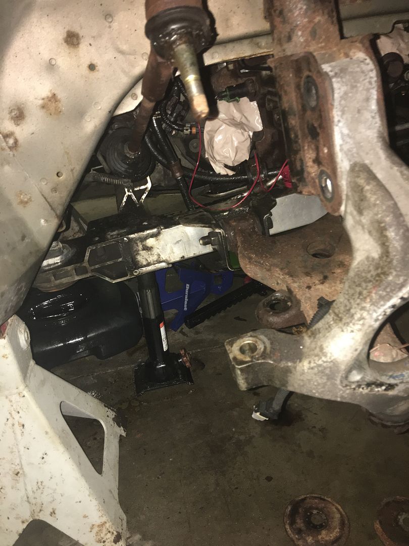

and the sway bar (first unintended injury - the mount for the sway bar to the ?A arm broke) and the sub frame dropped. Had to stop - need an 18mm wrench for the power steering lines
OK, so I took off the stabilizer bar and broke the mount. When I went to look for the part on a parts diagram all I saw was a stabilizer link. My car did not have a link, just a long bolt with a bunch of bushings in it? Does that sound right?
Thanks guys. Was worried the shop that did the rack last time put some improvised thing on there. Plan today is remove rack and then get all the parts.

Ok. Serious question. What oil should I use? Ok. Kidding. On the forums that usually starts a debate. Anyway. Water pump is going back on. I am going to pony up the $15 for the metal gasket. Do I use a sealer with this or not? I also ordered new bolts.
to really know you need to scan the abs.
oil dont matter. metal gasket, and no rtv at all on it. dry install.
the 4 long bolts need that sealant we talked about in the past, or they can leak.

Rack off
Sway bar broke (rusted end snapped)

Real question. All parts in my possession. I got new water pump bolts. They are coated with the blue thread locker. Do I still need to add more sealer to them prior to install?
New bolts aren't really necessary. I've only bought new bolts when the old ones were rusted solid or when threads got damaged. Suspension bolts come to mind since they are exposed. But since you get em...I would wipe off all the thread locker. Just use the thread sealer. Those aren't bolts that need locking. Caliper bolts might need locking, not water pump bolts though. Use your finger to smear black RTV on the water pump itself where the gasket will touch, and again on the engine block. Put it all together and let it cure for 24hrs if you can. Should seal up good.
Also, cardboard doesn't make you white trash. LOL. It's how cars have been getting fixed since the beginning of time.
its the 4 long bolts that need the sealant. so if your not talking about them, yes sealant is needed.
if you did get the 4 long bolts with the little bolts thats thread sealant on them already. install as is.
