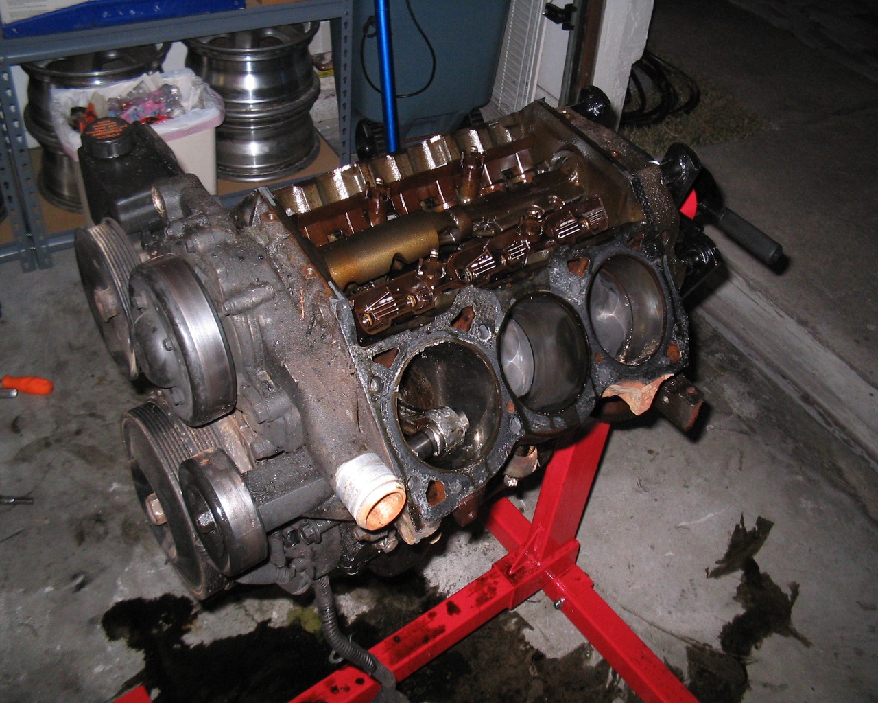

already have, and I'm trying to do this on the smallest budget I can possibly manage. And now that I'm going to end up with a high compression N/A block, I have to remove the pulley anyway to install a larger one. So I want to take it apart to get a better look at it and clean out the debris. If it's no good, I'll return it also with the rest of the stuff. I'm not going to return parts that may be usable because they're

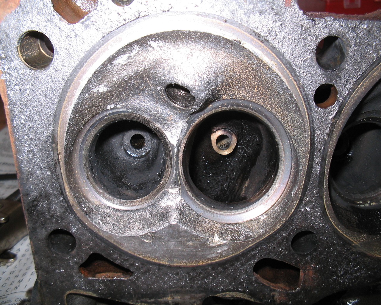

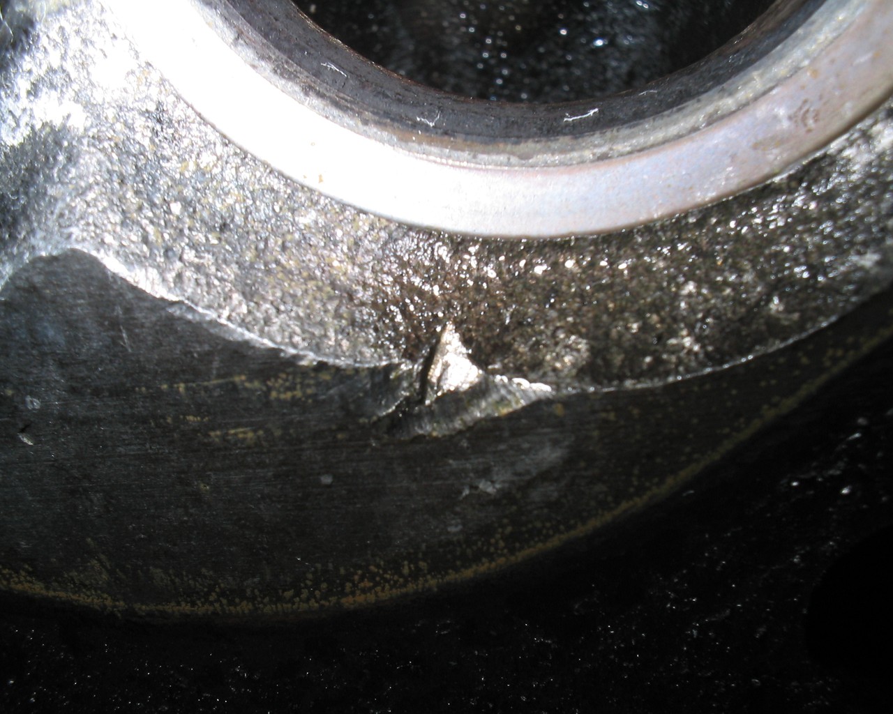

Now... Here are the heads. There is damage, the valve seats look perfect though.
Obviously it's not perfect, but keeping in mind that I can't easily replace these at my local pick'n'pull, they don't look all that bad to me... Unless I can find someone selling a pair for a ridiculously low price + shipping, these might be my best shot.
