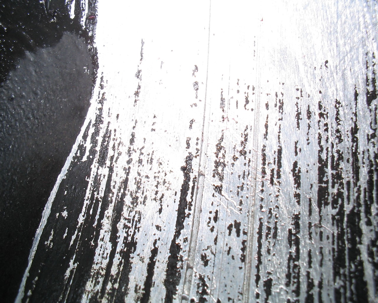

Here's the inside of the S/C. I cleaned it up a bit, this is the only area where the scratches go any further than scraping off the carbon buildup.
I will be looking around for heads and a SC, if I find any before my 30 day warranty runs out at a price I'm satisfied with, I will return these. Otherwise I think these may be alright just to get the motor installed and running, without any mods.
If that picture is of the case I wouldn't worry too much. The carbon would actually fill in spots where there are tight gaps and help on moving air. If that is of a rotor you have issues, the rotors have a teflon coating on them to help seal against the case and if that is flaking off you would want to look at a replacement. Again, seen several cases pulled apart and both of mine have scratches in them, its going to happen. Unless you get a brand new one you are likely to have some scratches and carbon and discoloration in it.
And unless you are getting rid of the EGR and porting and polishing the TB and Supercharger and LIM I wouldn't worry about carbon buildup. You will just flood it with carbon when the EGR opens up and starts working.
It is indeed the walls of the housing. But after that I did a closer inspection of the rotors and there were some more significant scratches. I decided to return it to the JY along with the block. Now that I'm widening my search to include non-W's I'll have a better chance of easily finding replacements, maybe Gen5 even. So I peeled off the Teflon to see how bad the scratches really were. They're actually not as bad as they looked with the Teflon coating intact, but it's too late to re-coat them now! I've got everything I need off the block, as soon as I can find a truck it's all going back.
