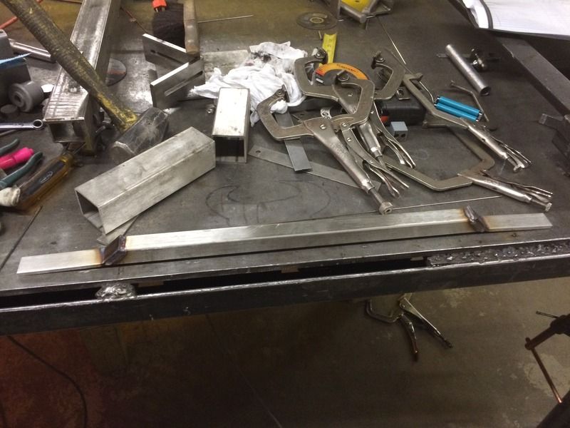

So I got a wild hair Friday and picked up some 1X1X 1/8" wall square tubing. Had a lot of extra 1/4X1" flat bar at the shop so I decided to make a couple of those strut to core support braces. The one over the battery has been missing since I got it. Here's the material as received then as stages as I finish and fab them.
Welding them up.
Finished welding.
I didn't really get any of the grinding and polishing but here's the end result. Now I have to do something about the engine compartment, and get some better bolts.

Those look great! Do you plan on making a front strut brace as well?
Sent from my SM-G900V using Tapatalk
Re: J57ltr's 05' GTP, playing with tuning.
Thanks, I'm not sure I wasn't even planning on making these it just kinda happened. I think I have enough material left to make one though.
Jeff
It's cool to see people making their own stuff. Nice work!
Thanks Jared, I like making my own parts, it's just easier that way sometimes. Now I think Aaron has me thinking about a strut tower brace....

Re: J57ltr's 05' GTP, Made SST crossbraces for some reason
They did come out pretty good. I like em! I dig the Spectre sticker, lol. STB would bring it all together...
Thanks! I was just out in the shop checking it out. Looks like I have enough I had only bought a 6' piece. I will need to figure out how I want the mounts I might see if I can have some laser cut next time we make some 3/16 material parts. Luckily everything we do is in 300 series stainless. either that or I will just make some plates. I don't know whether to have an adjustment in them. If that's the case it would be easier to make it out of round thick wall tubing instead of square.
