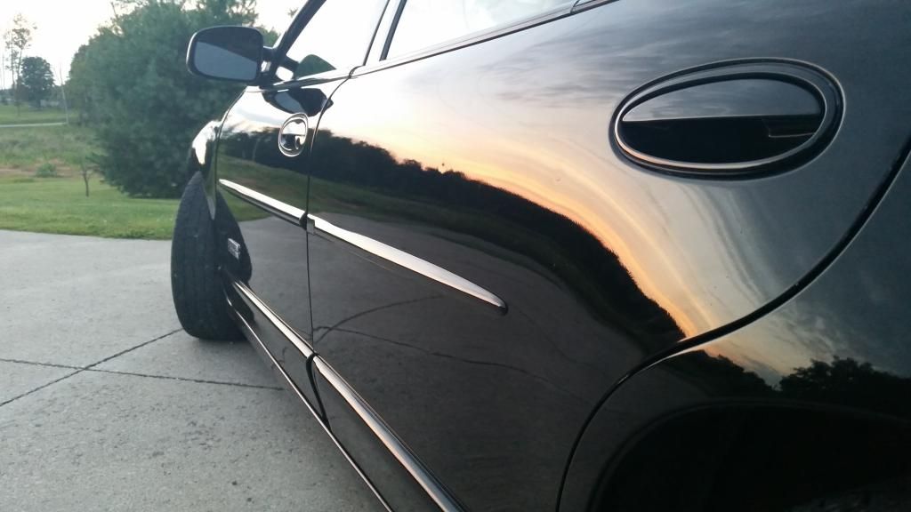

Might try and give my car a good detail tomorrow. Although I don't have a buffer. :(
