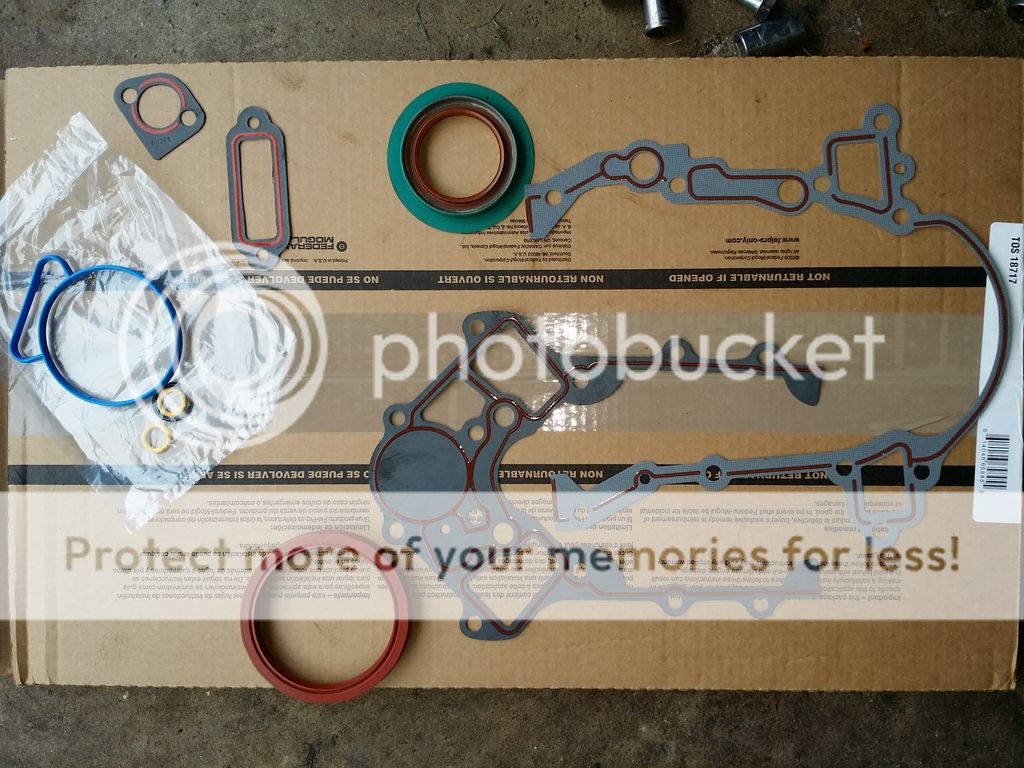

One more thing, I have all this gaskets and O rings that I don't know where they go :(
Can I get some help in figuring out the ones that I need to replace
