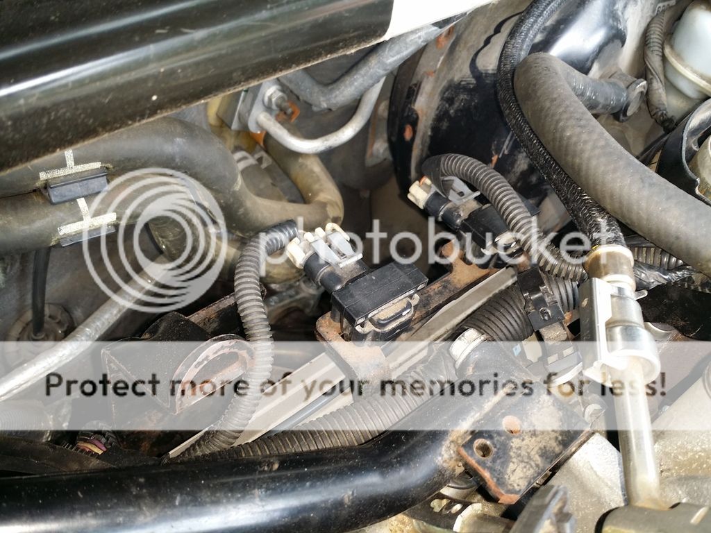

Well my engine light is not on anymore once the temp sensor started working
The other thing I found is this, I had this 2 connectors switched around
I don't know why they have the same connections
I think it was the one giving me the p0069 code
