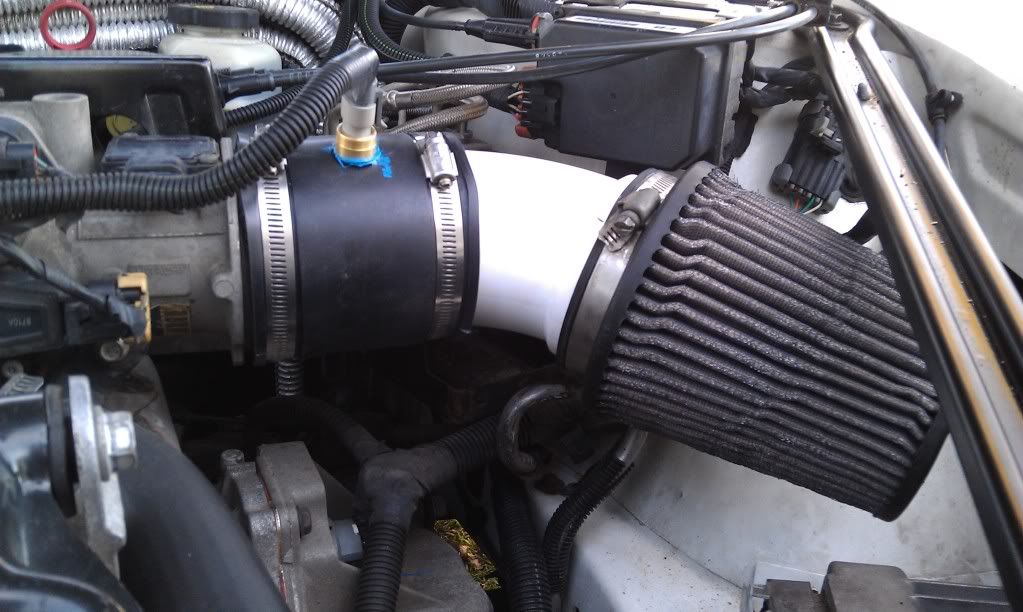

Did you leave the sensor where it is? Because thats what I'd recommend.
It's currently very loosely in the PVC being held by some RTV. (its being pulled cuz I drilled the hole to far away and its a smidgen to big and we didn't have the right size grommets at work)
I was going to get a new sensor and drill a hole in the coupler and stick it there so it would be tightly sealed.

Re: Danielle's 99 GT (updated 10/30)
go to a junkyard and just throw one in your pocket
I would, but the closest pull a part to me is only a half hour away, but I don't think I'll have time to run up there this week.
And it's going on a long road trip this weekend so I'd like to get it fixed before then.
far away is good.
Too close and it disrupts the flow near the maf.
Ok, that makes sense.
Should I still get a new one and put it a little closer?
I just don't know how tightly that rtv sealed it up and if it will eventually pull out?
Tada.....
All pretty and much better.
Just a little blue on the coupler, but I can deal with that.

Next time you need to toss a sensor or tube into a new intake.. consider looking at pcv grommets in the help section of the parts store. $1 or two can get a nice clean looking install that will come back out for future movement etc.
