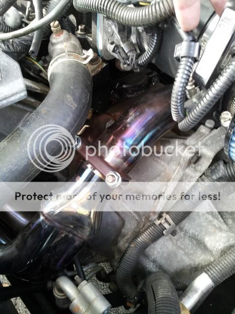

Modular pulley system is just a hub that is pressed onto the supercharger shaft. The allen head screws are what holds the pulley on. Pulley swaps are easy, 5 screws and the pulley falls off leaving the hub behind. Here's mine after I pulled the stock pulley off and put my modular system on with 3.4" pulley
Damn thats a sexy motor and charger. I'll measure the pulley and see how big she is. Does the outside diameter determine the pulley size? or is it the measurment of the diameter where the belt actually sits? As far as being special edition, It was the "air rails" or the rubber strips on the roof, and the hood scoops. That's all I can say for sure unless I could verify by other means or by VIN.
