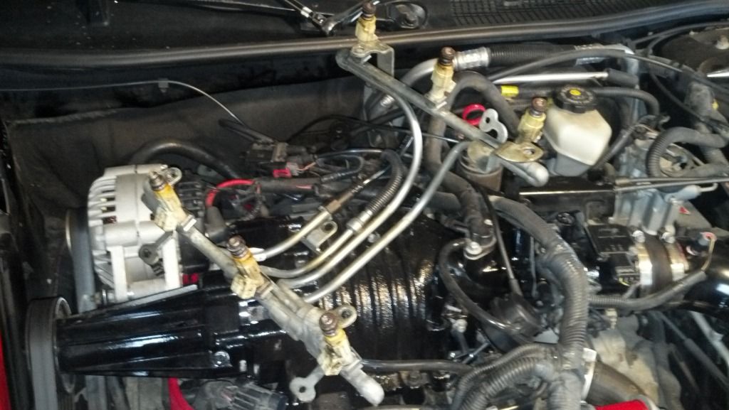

We didn't replace the injector orings because we didn't remove the injectors from the fuel rail..
Re: 1997 Black GTP, Tune Up Almost Finished.
I was told to change them.. They were like <$10... So y the hell not.....LOL

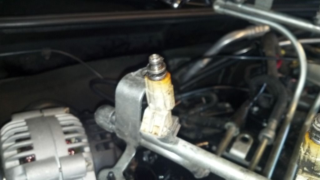

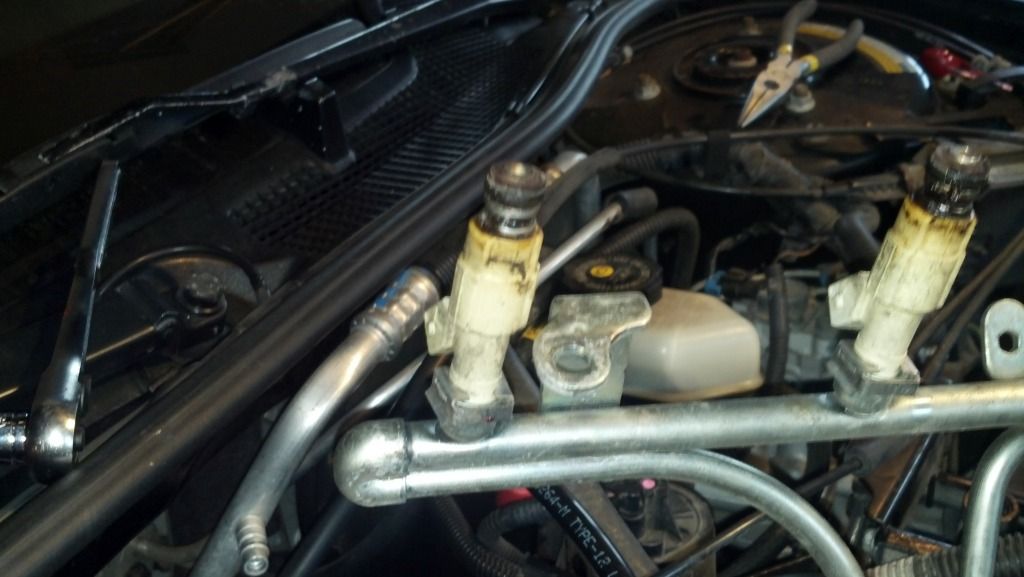

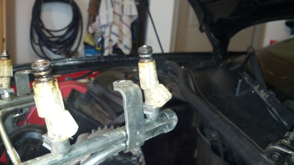

I checked the injectors out. Number 6 looks perfectly normal, number 3 was actually missing a piece as you can see, but still must work fine.
Far right, #6:
#3:
Just cleaned them with Carb cleaner and paper towel

The missing piece is the O ring. You kinda need those.
hes right. i bet its still in the injector hole.
i picked up a assorted box of fuel rated O rings at harbor freight for 10 bucks i think, you get about 12 of every size big to small.
ill remove the fuel rails again and see if its in the hole.
