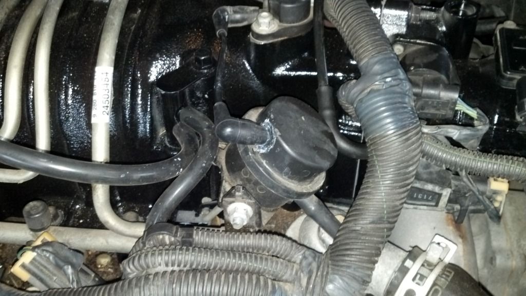

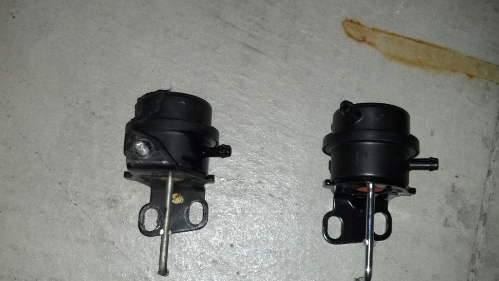

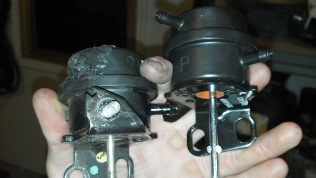

You can see the vacuum prong broke off my original BBV and i tried to seal it with black silicon, but i had a feeling that didnt work out so well. So i replaced it in general with a new Vac line. The two bolts are a b*tch to get and i couldnt screw the right one all the way in cause i lost my damn socket somewhere -_-
Original, tried to seal it:
New one installed with new vac line:
