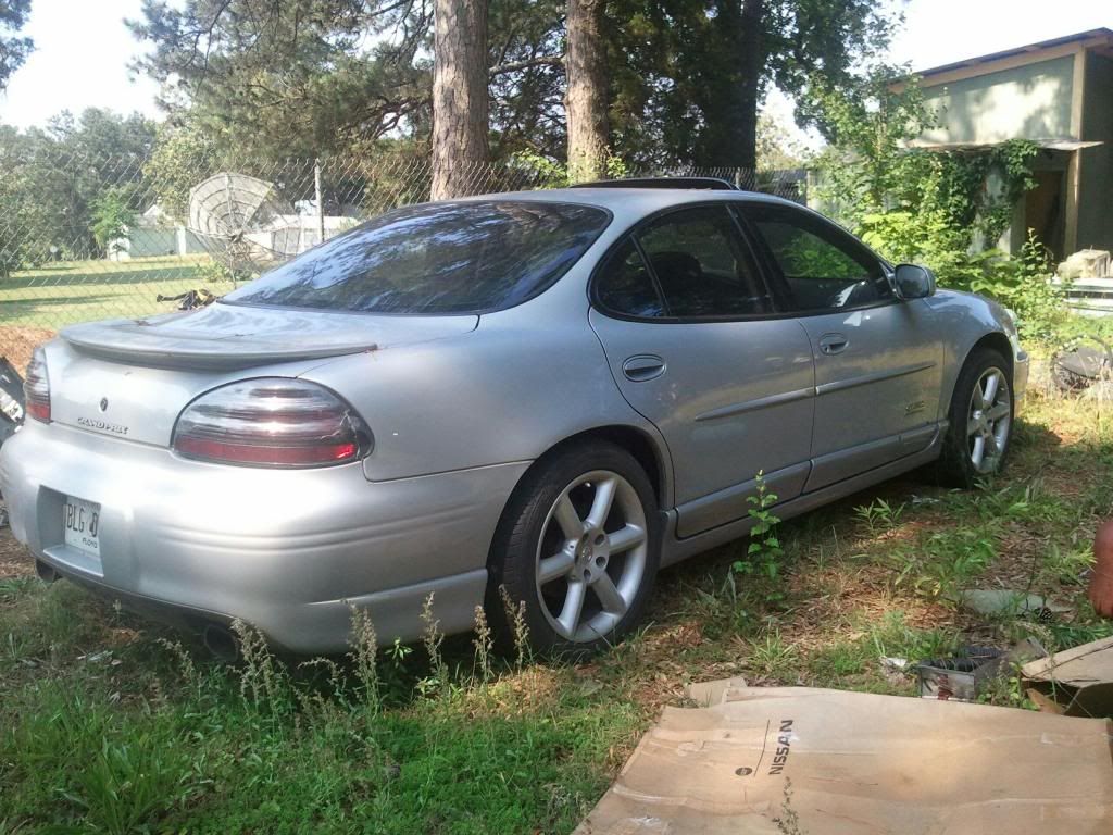

Need to find 5x115mm for an exact fit.
Mustang/Eclipse/ etc... use 5x114.3mm and they will fit fine, most recommend hub-centric rings when going this option just to be safe.
They seem to fit alright, would need to find out if the other styles would work. Backspacing issues could cause rubbing &/or a ghetto look that would get you laughed at.
those are nice. i can actually consider those.
Eclipse have a smaller hub bore so that is something you have to watch too. Just because its a 114.3 doesn't mean it will fit a GP.
