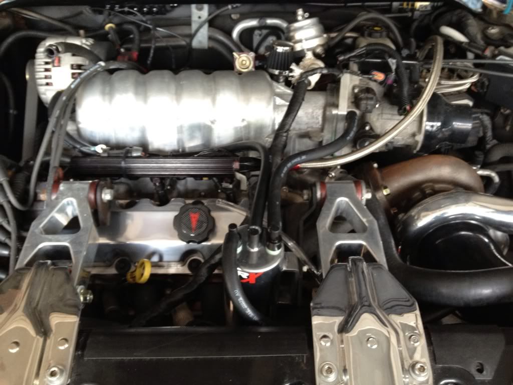

ooo shiny elbows installed

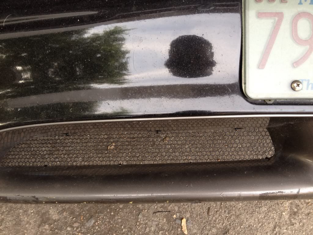

repainted my modders mesh with truck bed liner for some durability.

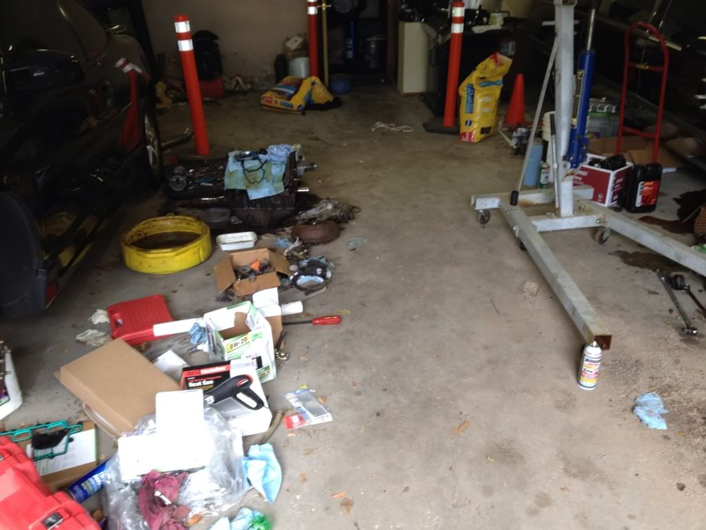

man was my garage dirty!! lol its still dirty but now theres less stuff on the floor.
Looks great already.
Between the dogbones, UIM, VC, and AN lines, perfect amount of shiny metal.
Perhaps just a polished inducer housing? Or are you going use a blanket?
Either way, looks great, looking forward to some more shots along the way.
Might be a tad too late for this suggestion, however I know you wanted jason to polish your UIM, perhaps cleaning then clear coat just to prevent further corrosion?
I'll be using a blanket but that goes on the exhaust side which is the rusty part. I actually might buy a polished heat shield for it soon too. The intake housing is in fact polished though. The uim will end up being painted black, it's not as done as it looks in the pic. Or I might buy the polished on from max I dunno yet.

Got my catch can installed today, came with a handy bracket that attaches perfectly to the motor mount. Gunna try and sneak out to do some more while girlfriend takes a nap.
