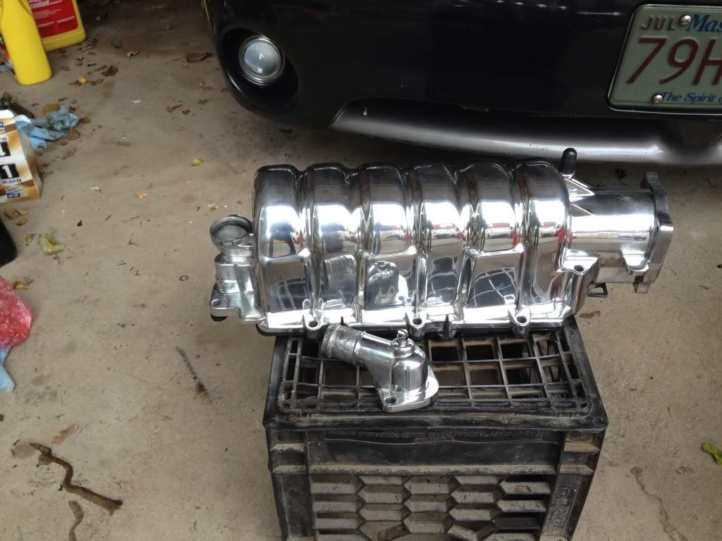

Read the whole thread. Looks good Brian. Good to see you and Jason yesterday, thanks for contributing to the intrigue build, and glad I could contribute by making your engine bay more shiney lol. Looking forward to seeing you get the car up and running. You guys all good with tuning or will need a hand? Let me know either way.
Yay shiny intake and tstat housing!!
No the intake was done by farnsworth and max bought it from him then I bought it from max. I would assume it was done by a machine by how good it all looks.
Joe eaton does not recommend polishing the blower, even though they look awesome, because the rough casting actually helps to dissipate heat.
