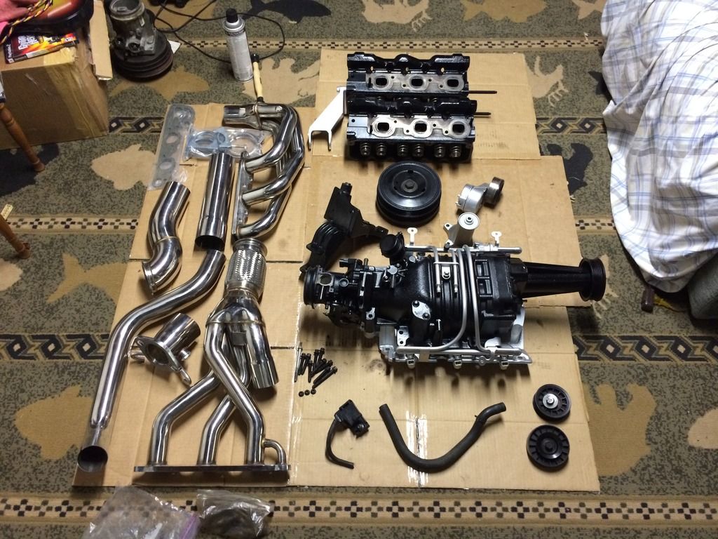

Re: Subway's GT: Top Swap Parts Are In -Jared Fogle would like to taste them in his m

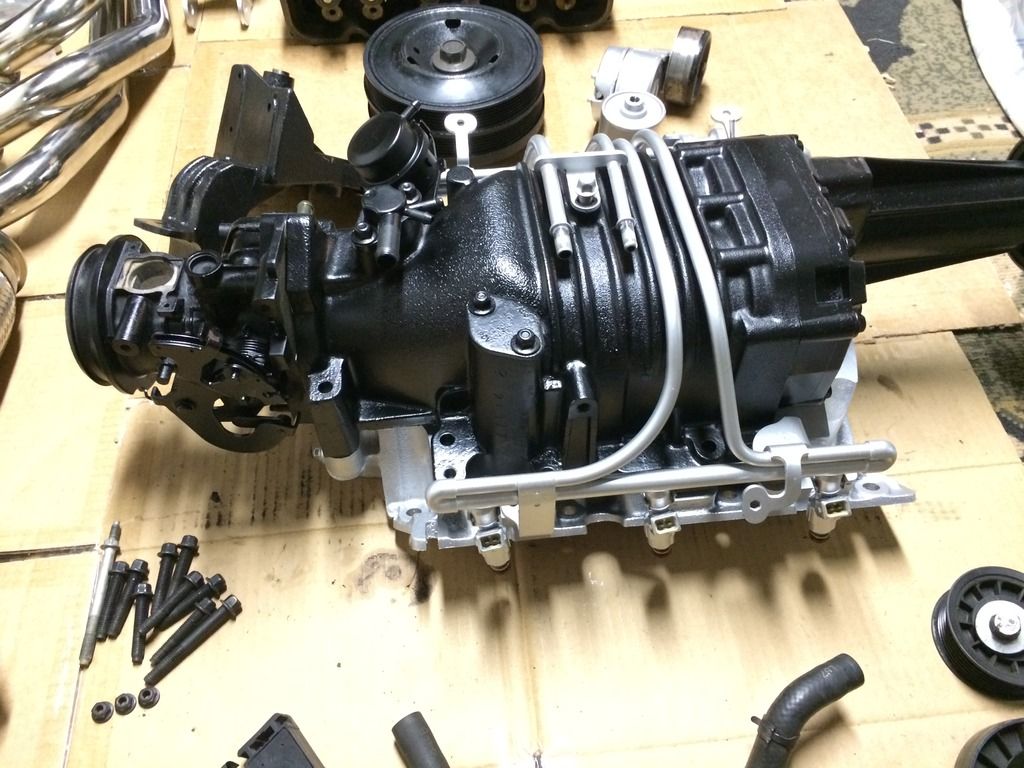

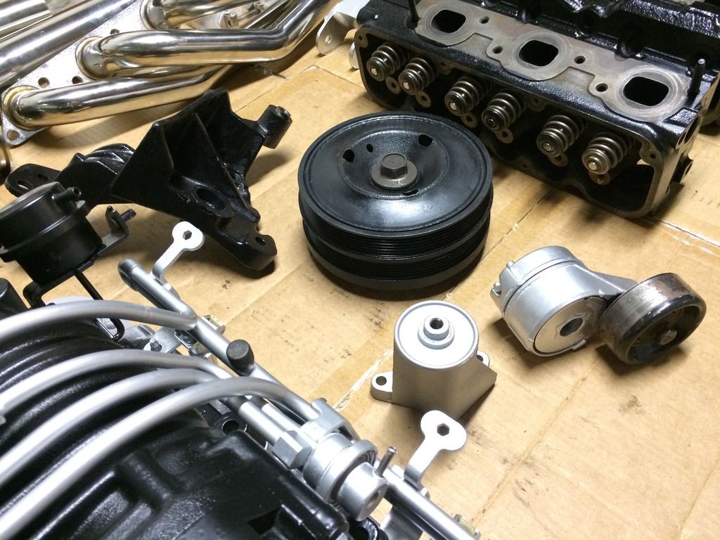

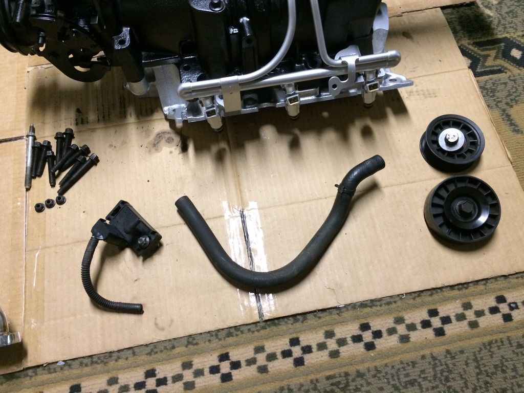

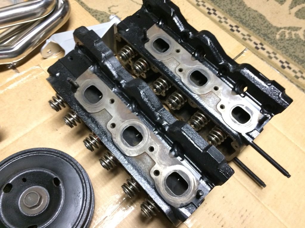

Yeah, so lately I've been painting, meaning everything is in good working order and can be assembled (if it was time to lol). I'll get some pics shortly. And then in a few days of everything together, but I gotta let the paint dry.
I never got pictures up did I... Hmm, shows how motivated I am lol.

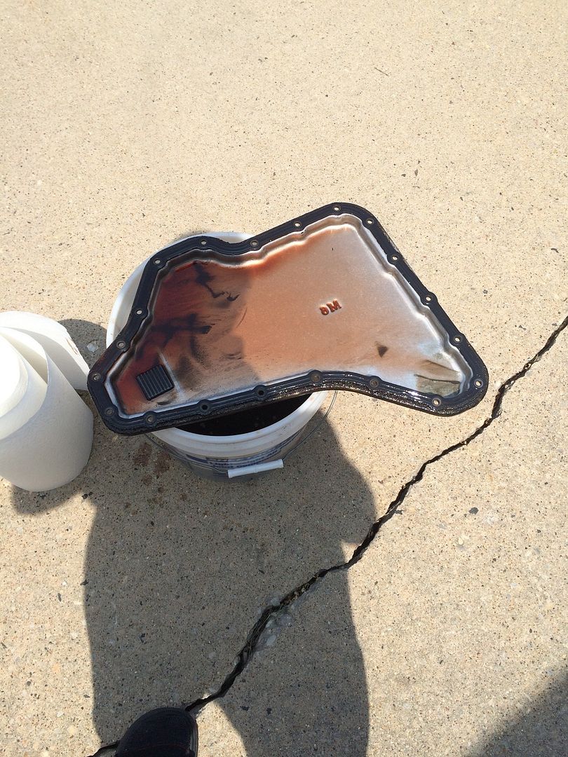

Changed the tranny fluid finally. Was a very messy job, but it got done. Only problem I ran into was that I snapped off the filter neck on the old one. Took me a good 5-10 minutes getting the broken piece out. Spent a lot of time cleaning the pan and gasket. So far there are no leaks with the pan being torqued to 10ft/lbs. A good amount of clutch material in the tranny, but no chunks thankfully. Hands were filthy so there are limited pictures.

Over the next couple days, I will be checking for leaks and keep checking the level to make sure it's still in operating range.

Should have installed a drain plug, way less mess for next time.
Oh yeah. Forgot about that. I did that
Either way - good job. Glad it turned out ok
I'm not pulling the pan off again... So no 2nd magnet and no drain plug. Those are great ideas for next time though.

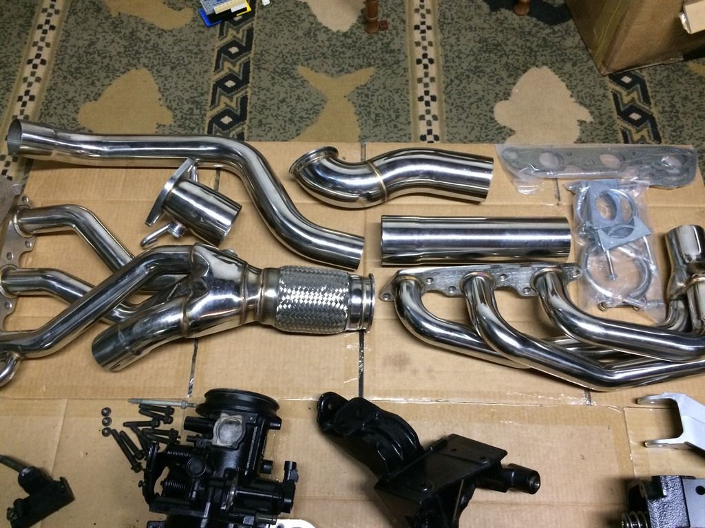

Got the last of my actual bolt on top swap parts. Thanks Bob! Can't wait to eat my sweet treat ;).

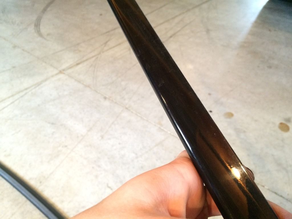

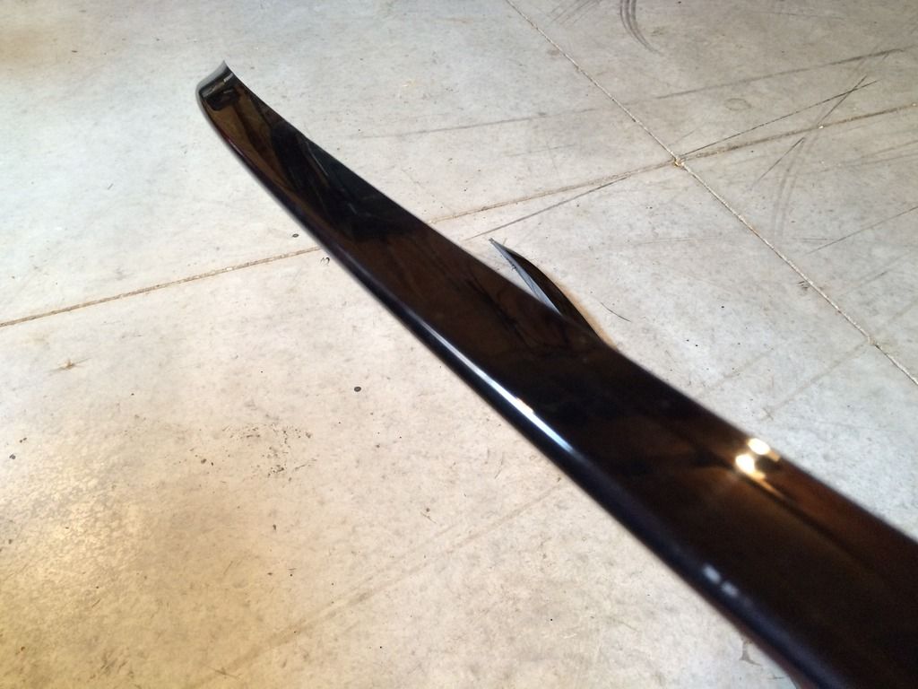

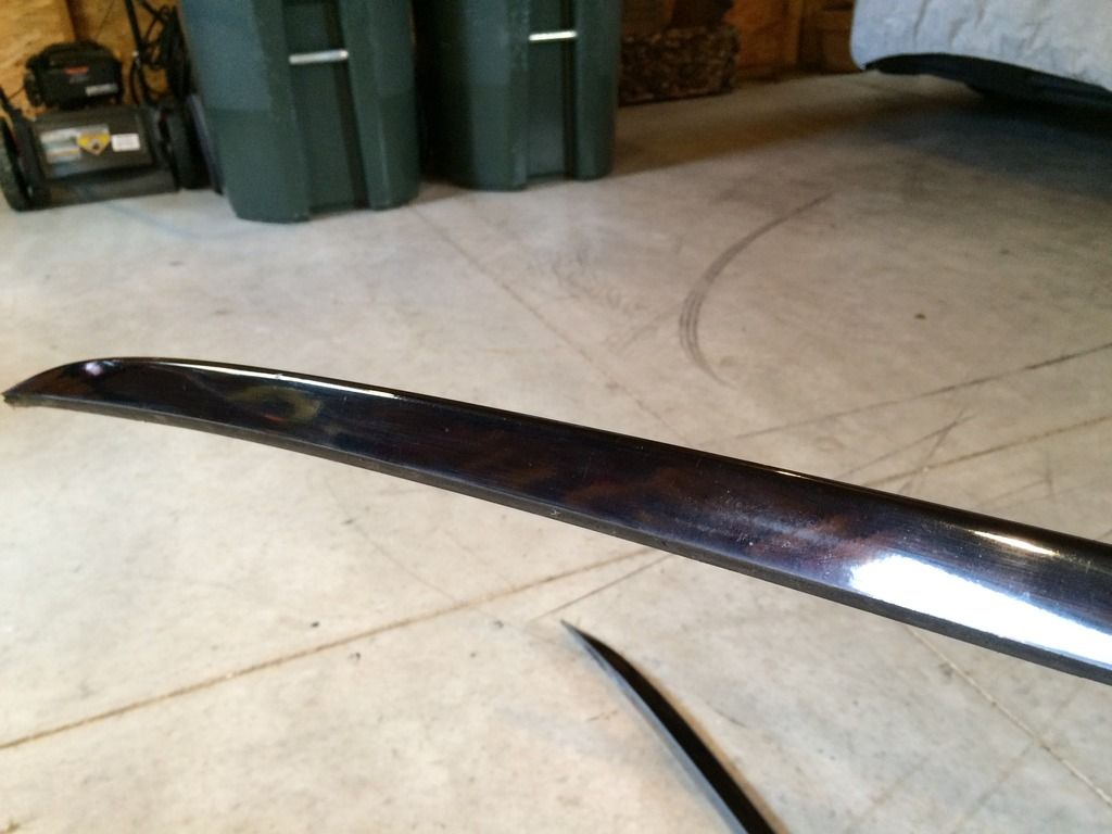

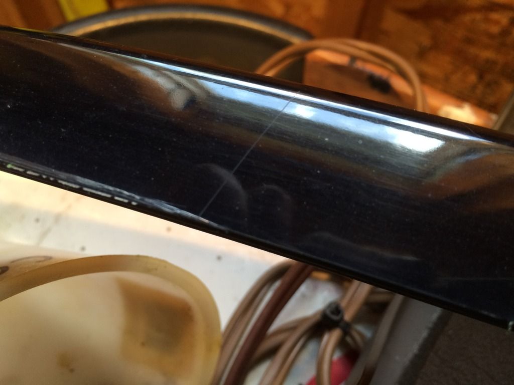

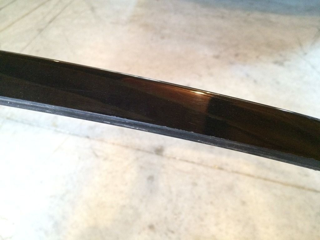

Made a trip out to the junkyard today. Was planning on getting a new window switch, idler pulley, and the bolts for L67 idler stand. Did find the pulley and bolts, but no window switch. But that's 100% ok because I got something so much better for such a great deal, that I could easily make 6 times the price on what I payed for them.
That's right, a set of excellent condition roof rails. And how much you might be asking? $20!!! It was such a steal that I almost felt bad lol. Only imperfections are the one scratch in the last pic, and a white spot that could be probably be buffed out. Super excited though.
