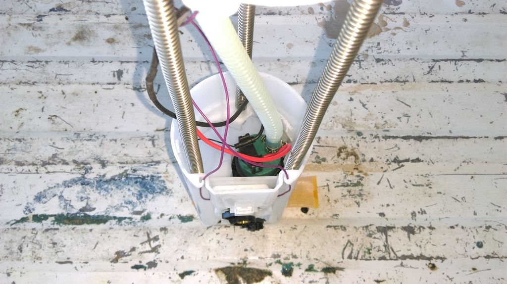

Finished the fuel pump retrofit. Here's an AEM 50-1200 in a stock S10 bucket. Not sure when I'll install, but at least it's ready whenever.

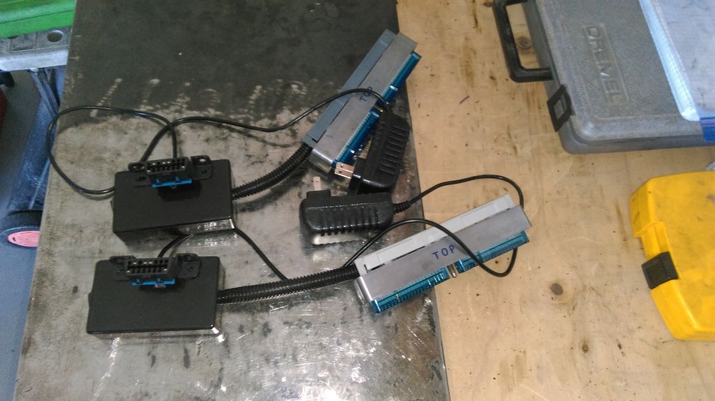

While I was there I grabbed a jack cover screw, a fuel level buffer module and a couple PCM plug ends. Spun the cover screw in before I left the parking lot. Tried the buffer module when I got home. No change in the gauge. Still reads empty. Turned the plug ends into a couple offboard tuning interfaces.

you need to add 04+ connectors onto your off boards. Look very nice. Where do you get the black boxes?
Re: Project LQ4 - V8 S10 - Now with CalTracs!
Thanks Bill. I might add the 04+ connectors to one in the future. Right now I'm just concerned with the LS swap guys running the 411 PCM.
Boxes come from ebay. About a buck a piece. Search "Black Plastic Cover Project Electronic Instrument Case Enclosure Box" About the perfect size to fit the mess of wires inside.

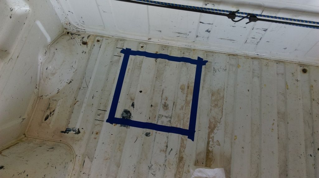

Well I laid out the access hatch. The "Y" dimension, though not centered over the pump, is big enough to land the cuts on the crossmembers. The "X" dimension places the cuts in the valley of the bed ribs and close to center over the pump.
That look about right?
