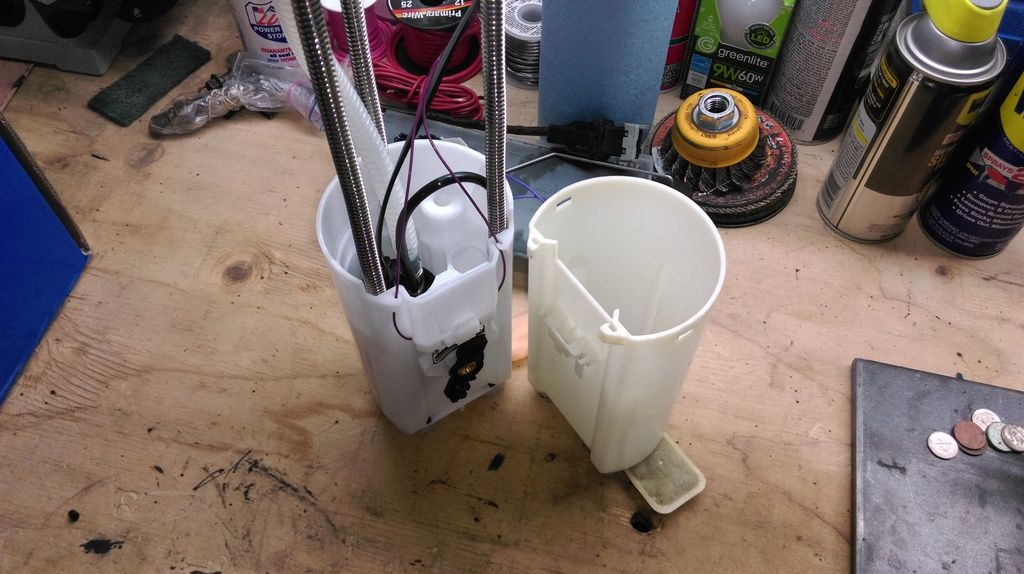

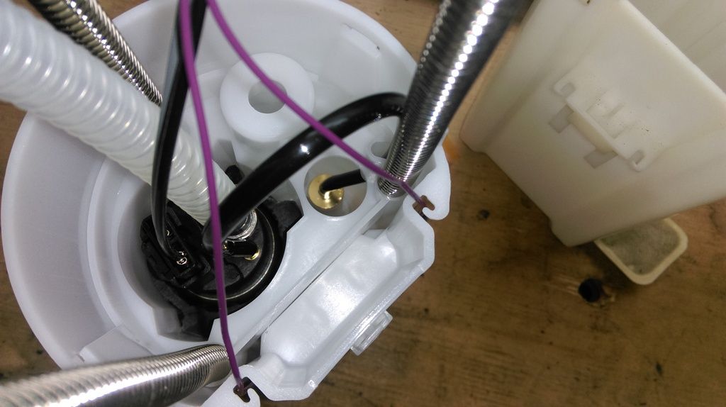

Ordered up a cheap $30 Ebay fuel pump assembly the other day. My plan was to fit an old AEM 50-1200 pump into the new module.

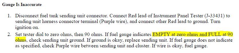

Not sure it's going to work though. Pretty sure I need a 0Ω-90Ω sender, and this one is 40Ω-250Ω. Still researching that...
Interesting side note though... It's a venturi bucket
And the bottom portion of the S10 module looks identical to the old Grand Prix module. Or close enough that I can't see any differences.
What's my point? Let's say you got yourself a nice venturi pump but only have a standard bucket.* Get a $30 S10 Ebay module, swap the top and be good to go. (I assume. Certainly worth trying)
*That's what happened to me. Ordered a Racetronix venturi pump for my GP, only to find out the original venturi bucket had been replaced with a plain non-venturi module. I cobbled something together, but this would have been a much easier fix.
