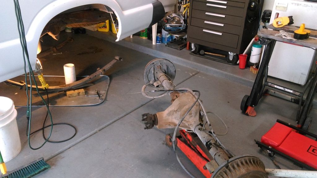

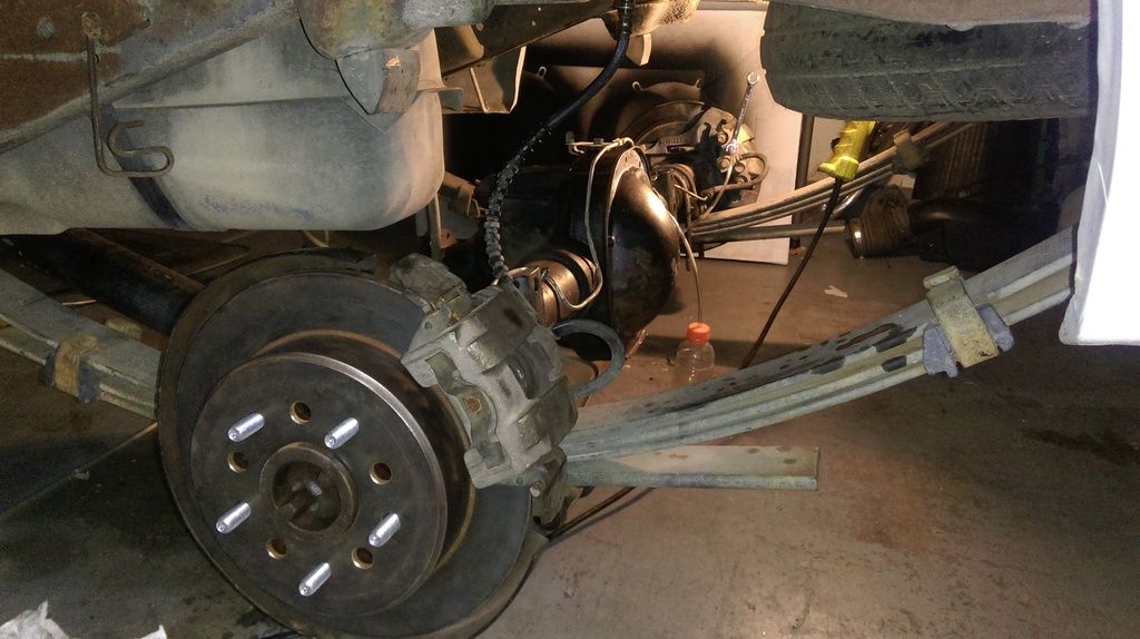

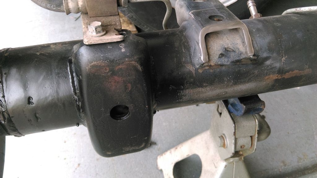

Lopped the bottom ear off the sway bar bracket to clear the shock
Started pulling the S10 rear
And the 8.8 in
I need to stretch the holes for the lower mounts a bit. If all goes well, I should have this thing fully mounted tomorrow and maybe even get a jump on bleeding the brakes.

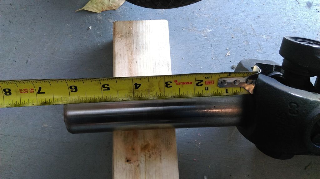

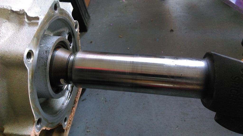

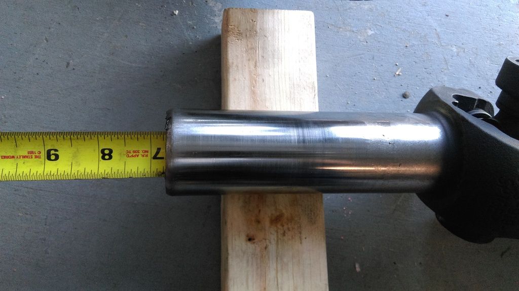

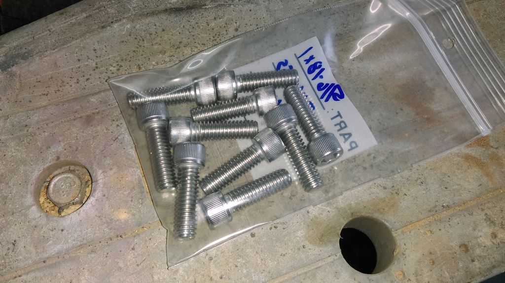

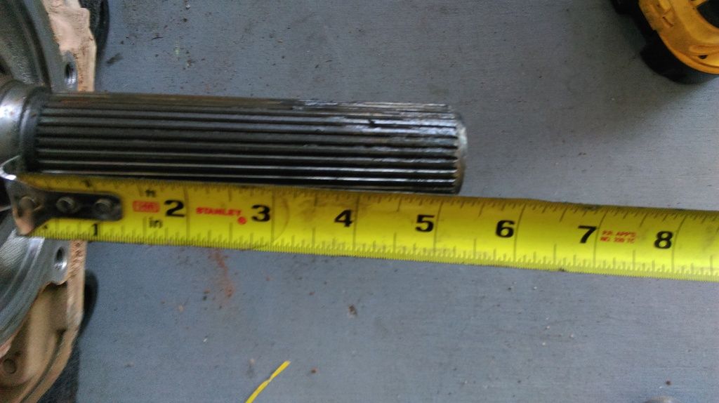

Rear end is in. Brakes are bled (I think). Wheels are on. Measured for the driveshaft. Should be dropping it off on Monday.
And my shorter screws came today, so I should be able to pop the cover on tomorrow or Monday.

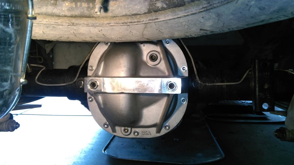

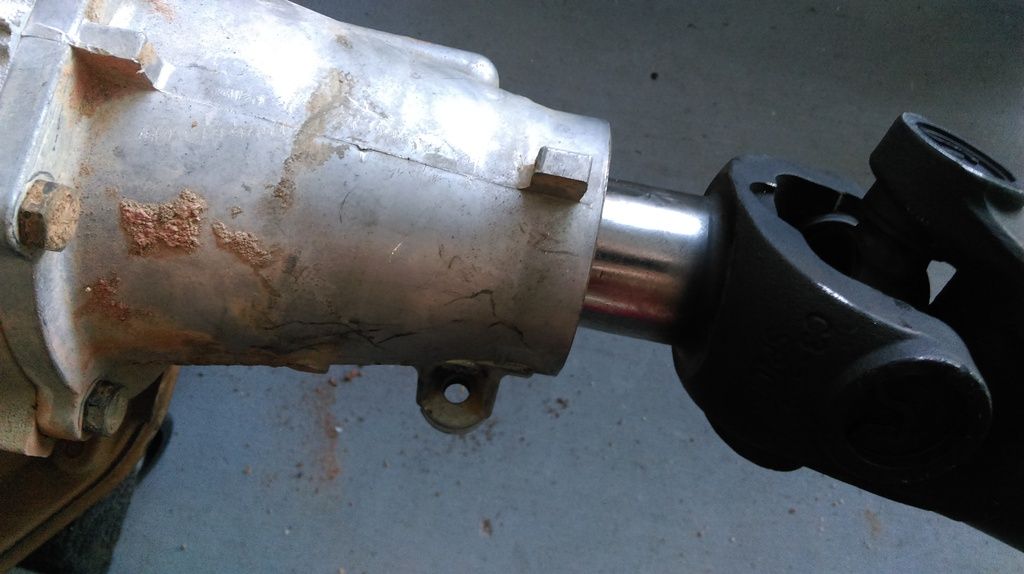

Whelp, good news and bad news... Good news; fancy diffy cover is on. I'll let it cure for a day, and probably fill tomorrow.
Bad news; pinion angle is way off. Supposed to be 4° up, and it's actually 3° down for a total of 7° off. I (falsely) assumed the perches were level to the ground when the rear was installed and went off that... Derp. I'm going to put it all together and see how bad it is. If it's tolerable, I'll just drive it till I build the next rear and make corrections to that one. If it's un-drivable, I'll get some 6° or 7° correction shims to get me through till I build the next rear. Either way, it'll get corrected next time.
So, to be clear, with the rear end sitting on jack stands and the perches level to the ground, I need the pinion 10° nose up to achieve 4° nose up when installed. Lesson learned.

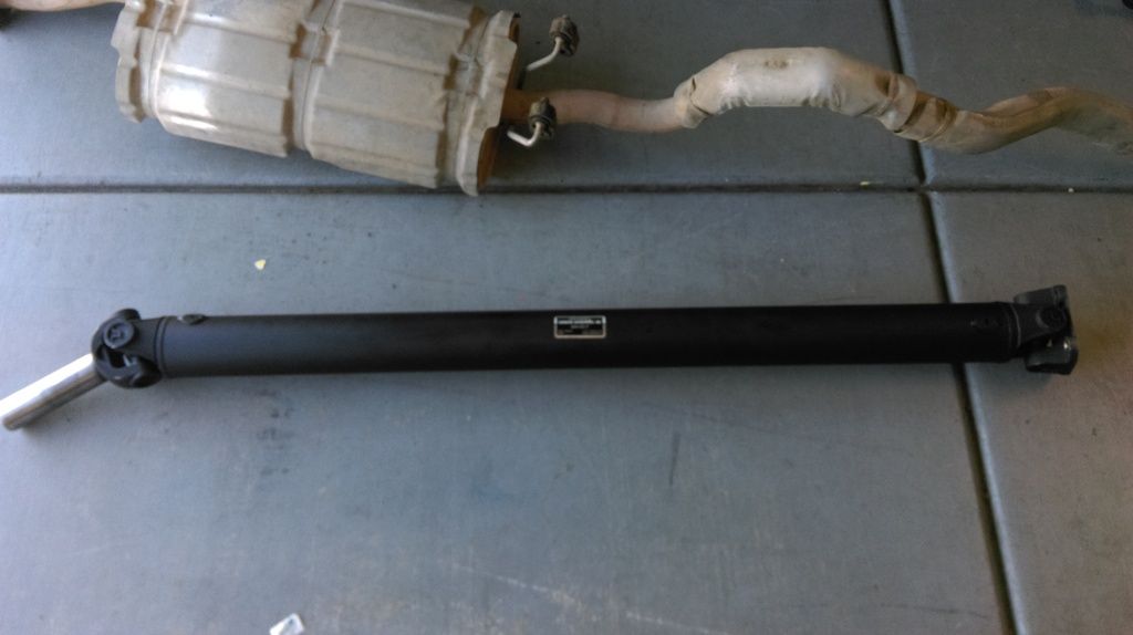

So I dropped off the driveshaft today. Should have it back in a couple days at most. Also filled the rear. Decided to be a guinea pig and try the dirt cheap Wal-Mart supertech synthetic. Claims to be for LSD's. For $6 a quart, I had to give it a shot. Especially since this rear is only temporary.
