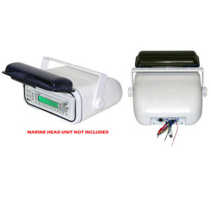

i had my radio in this box, its water proof.
they also sell marine radios that hold up to the beating of being on a boat, and they are more water proof then a car radio. i had the same HU for 10 years, worked great. you also want to hook it up to a vhf radio for safety ( you want one trust me) and then you can run the fm antenna wire to the vhf antenna.
being you will be towing the boat, you want a antenna mount with a swivel lock, so you can lower it when towing it.
if you dont have dash space this works well for top dash mounting, but the plastic U mounting bar breaks over time. so i made one out of flat metal stock when it broke.
they also have a water tight face cover just like this for a dash mount.
id hose test it, just to be safe. boats get wet lol like more then you think, then theres rain, and then just sitting there parked on a trailer.
