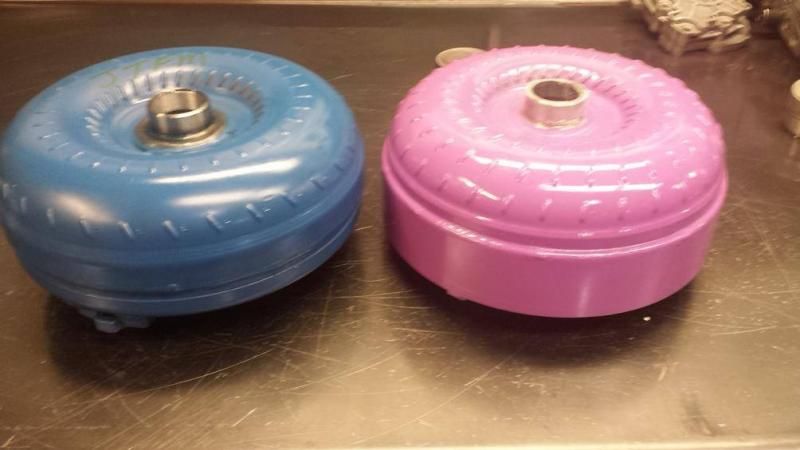

Dave @ TEP still has car under the knife... Working on getting the spacer plate made for the new beefy 3 disc converter.

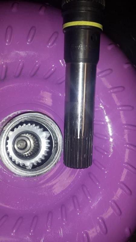

Also GMR input shaft cleaned up a little bit to not cut into the o ring now housed in the converter.
Also went ahead on coughed up the cash to get a 2.93 GMR 1" set. Dave thinks will help some on the launch
with a bit longer 1st gear. As once into 2nd gear, will be locking the converter, as it was built to do so without
worry of burning it up. So will either have a 2nd GMR 3.29 gear set for backup.. or one for sale eventually :)

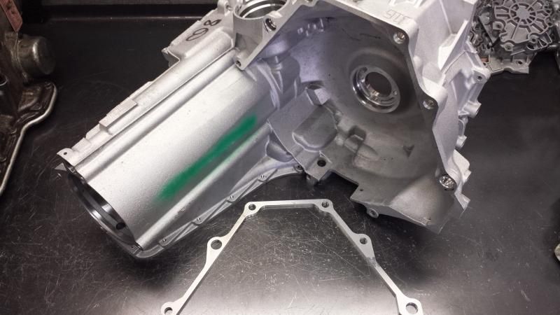

Idea of what the gap will be for the spacer plate..

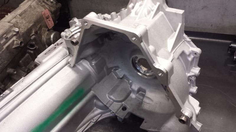

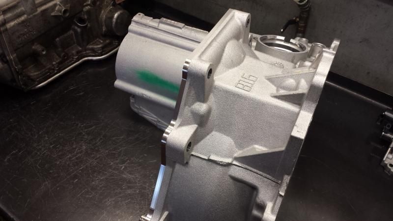

Internal Brace for the trans. Should help beef it up from flexing. Also converted to 2.93 GMR gears (not in picture)
Trans Spacer for new converter

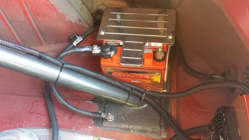

Battery moved

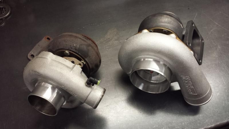

Turbo Damage

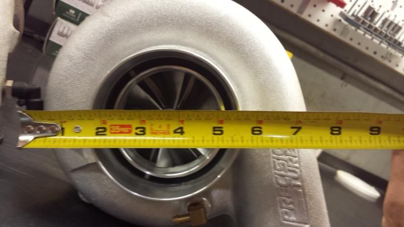

Old Stattama T67 vs New Precision 7675cea ball bearing, billet wheel turbo.

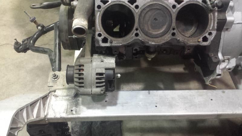

Dave started on moving alternator and getting ready to do the new lower mount setup to remove the upper mounts all together.

The mount setup was Daves idea to do all of a sudden. When i dropped car off I left a LS4 mount so could be a single upper mount, but he didnt like that idea.
To be honest, I am not sure what method Dave is going with. Apparently whatever method he's doing, he has done at least one, maybe two of before. He hasn't gone into super detail about it. Just waiting
for the pictures of when its done. :)

Ya the LS4 mount I bought, they are stainless steel vs the aluminum ones for the 3800s. Requires to be drilled out to bolt on to a 3800 head.
But its much stronger, thus why the GXP has one mount. Guess i'll be reselling it soon.
