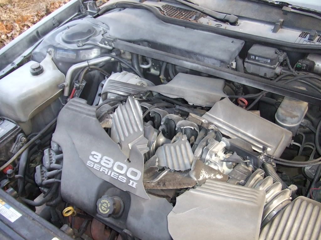

- 3800 problems
Wow man... Wait so how does a regulator cause the UIM to do that? I wanna see that recall. But not sure I can search exploded UIM and get results. I hope my year wasn't known for that, mine's stock.
No just trolling bro. That was the fire recall, car burned on the side of the road. Valve cover gaskets failed... I think. FPR shouldn't cause that.
Right, but I mean this picture. I've seen this many times on the forums, never found and understood the problem.
Ah yes THAT one. I have no idea about it. Seen it happen on "track cars" with a fueling error and a back fire into the intake and plastic plenum goes boom... usually NOS issues.
