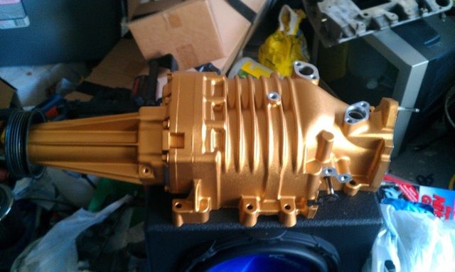

Finished up doing my LIM gasket, got everything sorted, fired it up, burped all the air out of the system, took it for a test drive and then at WOT.....SAME SH1T!!!! Only produced 3.0lbs of boost, even the factory meter lit up only half way. WTF Is it possible to have a bad SC. All the vacuum lines are good, new (non leaking) LIM gasket, I just don't fuqin get it. Makes me want to sell the damn thing after throwing parts at it. I also painted the SC. Here are some pics.

should have painted the valve covers while you were at it. SC looks out of place sittin on top of that dirty engine...............
Re: Just a Topaz Gold Metalic GTP
I want to paint the VC, but I am only home for a week for Thanksgiving. My house is in TX and I'm stationed at Fort Polk, LA.....so the wife hates it when I come home to just work on the car. I like to spend time with my family.
