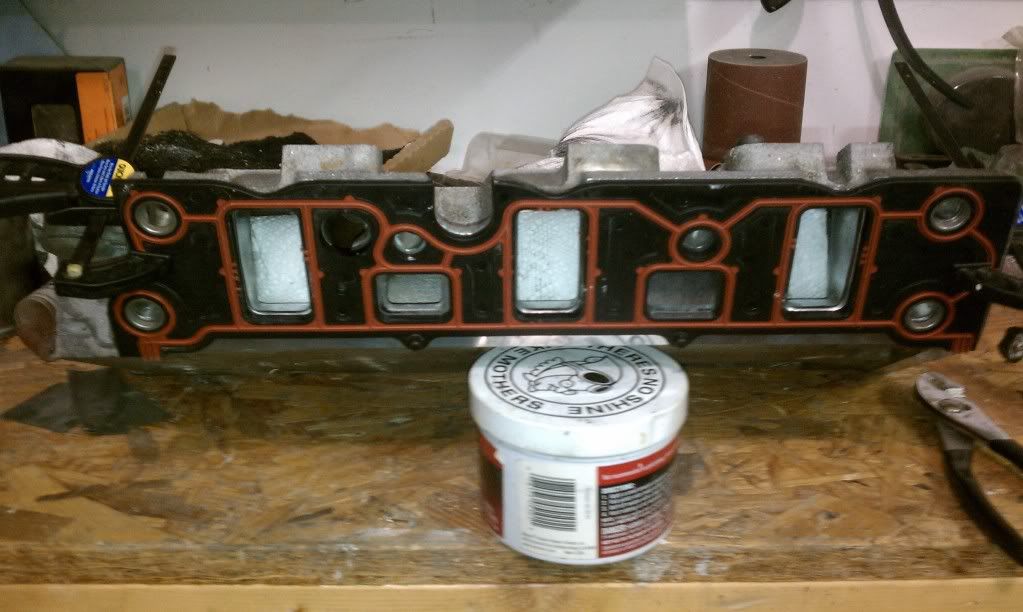

I Got Parts!
Valve locks, you can reuse yours.
Head gaskets, I've had fine luck with Fel Pro's. I do copper spray them.
Head studs, awesome.. teflon paste for sealant and use the hex key to bottom them out.
Exhaust manifold gaskets - reuse factory MLS gasket.
EGR block off - penny and some JB weld in the manifold to block it off. Otherwise, most blockoffs are a small piece of aluminum or steel with a hole tapped in it for the bolt. Me, I've filled the SC egr port as well to smooth things. Just saying. Then you use a piece of metal at the header or put an egr in place to look legal.
TB spacer, no need
04 T stat housing, you can mod an earlier version if one isn't available.
No L32 map sensor to clean it up back there and use a connector that won't be over the exhaust to get brittle and break?
34# injectors????
Fuel pump rewire, what about high flow pump (TREPerformance.com $70)
Valve cover gaskets - and grommets
Coolant Elbows
RTV
Pipe sealant wtih PTFE
so I did some pricing and with out even everything I needed it was 700 dollars just for bolts gaskets injectors and what not... any tips on where to get these things at a better price
I'm pretty sure i still have most of the bolts. I'll give you the big box of bolts and you can sort through them.

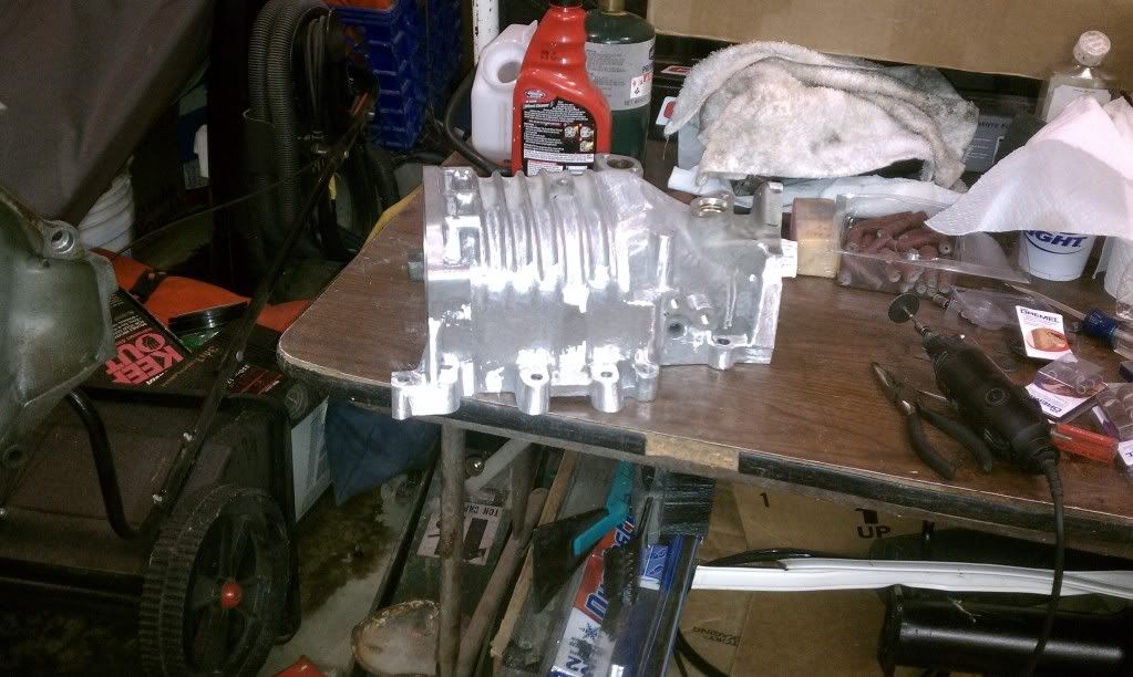

Behold! what I got after close to 6 hours... yep just this side lol. I also have the coolant ports ontop plugged and the a good chunk of the top cut out since I decided to add on a ssic. I'll get more pics when I finish the LIM completly
