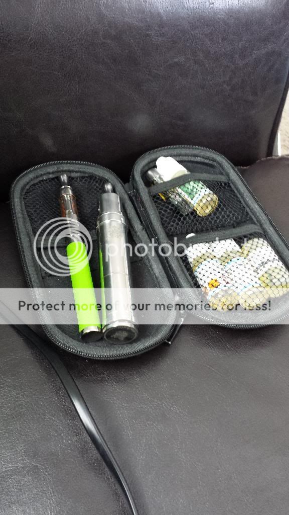

so i picked up this stuff today..(used, $100 for all)
the one is a mini pro-tank which is the throw away kind (the atomizer), which i understand.
the other is a chi you mojo mod with a igo-w atomizer and drip tip, which is the one i'm going to have to play around with in order to get how it works..(three 18650 batteries for the rebuildable one, too).
so i need to rebuild the igo-w before i can use it. the mini pro-tank stuff i can clean and use as-is, no biggie.
where should i start looking as far as rebuilding the atomizer on the rebuildable unit? basically, which wick and wire should i be getting in order to get it going again? and what resistance should i be looking for on the coils? i'm not trying to make this complicated, but i'm not an idiot so i can handle doing any of the building necessary.
