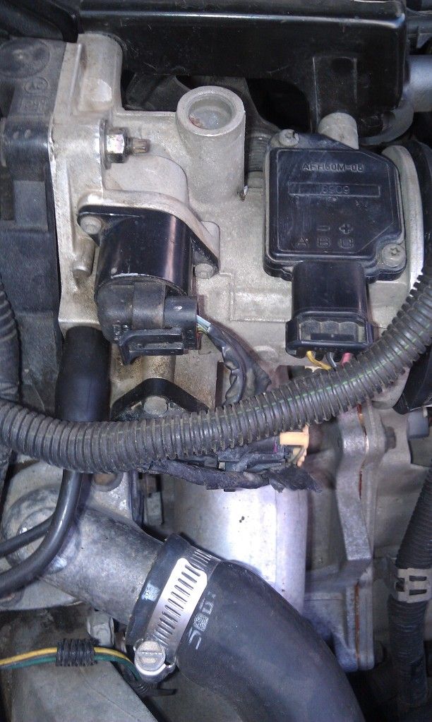

The MAF connector:
All the sensors on TB

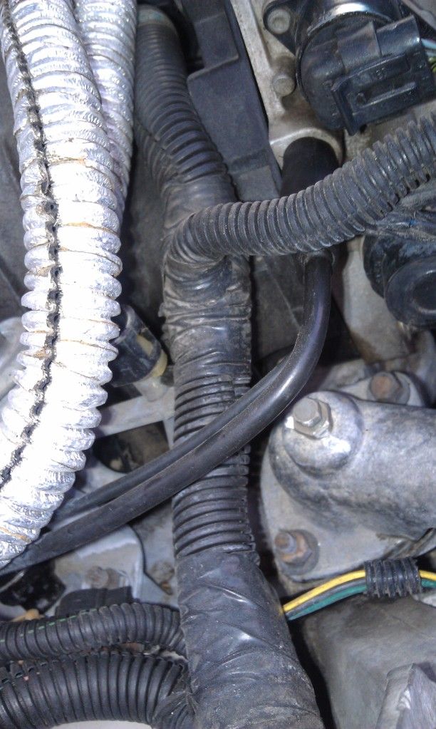

General wire/corrugated stuff shot:
I didn't tear any of the corrugated stuff or electrical tape off, but of the things visible - it all looked ok to me.
corrugated stuff <<<<<i like that one lol its called wire loom. from the pics they do look ok. id take the plug off flip it over and bend the wires back so to see the very ends where they go into the plug. you can un tape the ends of the wire loom, and the loom has a split on one side, the wire can be pulled right out of it to get a better look.

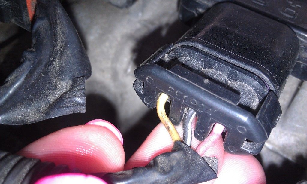

Ok, went out and unplugged the sensor and flipped it over.
This is what you get: (I was having a really hard time getting the camera to focus)

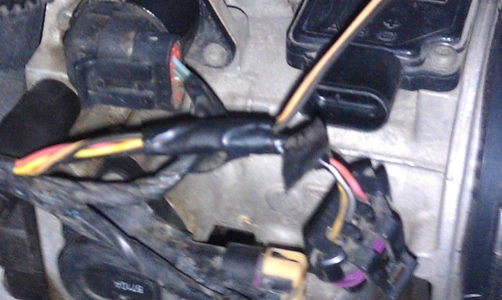

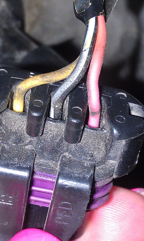

And here is with some of the tape off a tid bit and out of the "wire loom"
whats that mark on the red and black wires, is that black marks from where they lay on the plug or is that messed up some. slide a knife or your nail over it to see if its smooth, or dented in.
red wire dont look to good.
the weather pac seal matches your nails lol
Your lucky the car is parked close to the house...But it's dark now, so this was the last trip out there tonight.
The red wire is all one color, flash makes it look funny. And there doesn't appear to be any mark or anything. I couldn't feel all the way down and didn't wanna pull the wire out. But yeah, no grooves.
