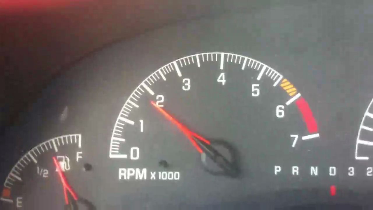

Per Bill's suggestion I went out, driving 50ish mph, Aeroforce said current gear 4, in D I was sitting at 2k ish rpm. I kept my foot on the throttle in the same place and manually shifted to 3 and there was NO change. Went back to D and no change.

And here is the tach. Cruising at 50mph~ in D, shift to 3 and back a few times.
