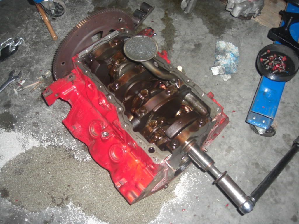

And some pics...I would just like to say I am being pretty damn lazy with this though. Motor was pulled out last weekend as I have just looked at it everyday dreading working on it. Well...here is the damage!
Your typical Clevite 77 Cam Bearing.
AAAAAAAAAAAAAAAAAAAAAAAAAAAAAAAAAAAAAAAND...your typical bluegtp91 cam bearing :D
More crap thrown all over...
And the oil pan...hmmm, another cam bearing? Damn right.
Best part about it was the XP was perfect when it was pulled out, oh...and the fact that there was no cam key in it either...not in the oil pan...no where. LOL I love this car. So...all that is left is either IC or 100% Meth and the injectors. Then get the block line bored/hot tanked and the pistons cleaned up and she'll be ready to rebuild :D Branson 2010 Here I come LOL
