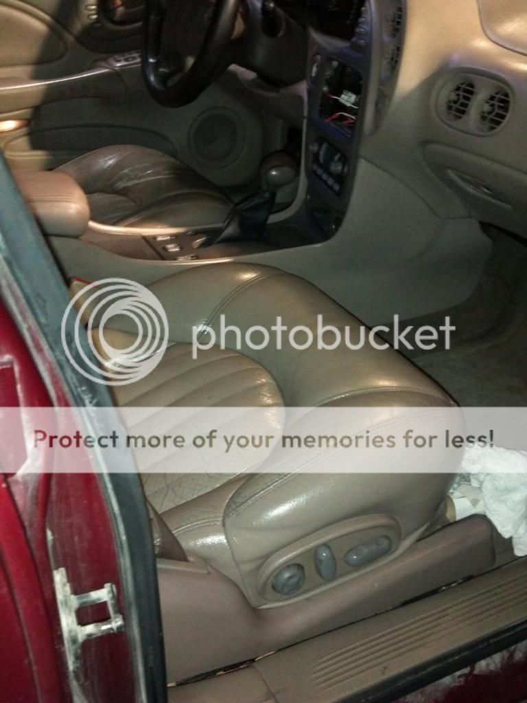

update:
ugh, its getting there
Re: $700 Bonne SSEI Project
I have no idea how to get that "stuff" off the seats. the previous owner was a smoker and its like some sort of smokers crap
Magic erasers work wonders on leather with some all purpose cleaner, just be sure to condition them afterwards. Nice project by the way.
I wasn't kidding when I said like purple power and a green 3M scrubby and brush 2 probably for the hard to reach areas. use it full strength and scrubb the ever livin turpentine out of it. rinse it really good with water, to get rid of any kind of stickiness. Let it sit for a day/2 to dry and then treat and re-treat with some leather goop.

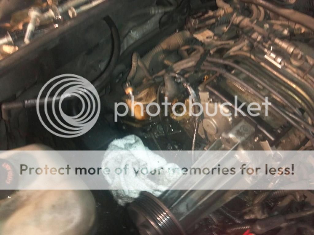

Well...it's a Bonne afterall.
Swap out the marshmellow with hockey pucks. Get the MSD's off there when you can, they tend to fail at high rpm within a year.
Now...here's the challenge. I dare you do swap the front valve cover gasket. You'll fall in love quicker than you think. And your rear shocks are beyond easy to swap out.
what do you mean about the front VC gasket? and I picked up both new rear air shocks. seem simple enough, 3 bolts and 1 air connection.
Open the hood and look at what it would take to replace the VC gasket on the bonne, then walk over to the giant trash pile and look at that one.
Soon you'll be talking about how great the Bonne koolaid is... lol
ah yes, I seen that the coil pack assembly isn't covering the VC like on the blue car, that is nice
