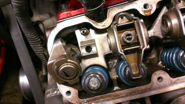

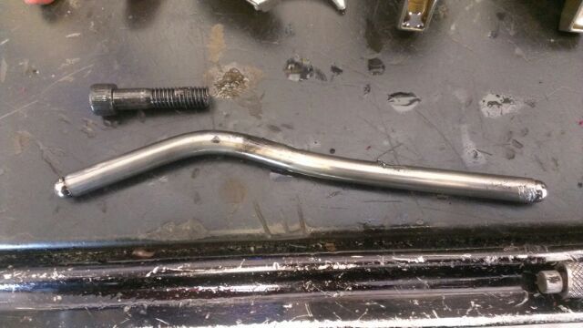

Well guys, here it is. Turns out it snapped another rocker bolt and the rocker came loose. Why did it happen? I don't know, but I'm not putting the blame on us, or the rocker bolt, or anything else lol The good news is, it's fixed. Now the real funny part is, when the guy put it all back together and figured out everything was okay, he took it out for a test drive and on one of the WOT runs he made, it snapped the input shaft in the trans. :th_laugh-lol2: I guess that's okay since it's getting a trans build anyways, which means I should have the car back soon!
Aaaaaaaaaaand that's my pushrod :th_depressed:

Yep thread locker on EVERY bolt... I hate to say it but I almost think you got a bad set of rocker bolts...
Re: Daytona 500 NIC Cam (Heads/GenV On!)
I don't see much thread locker. Tough to believe that with thread locker & the correct tq spec that bolt came loose. Did you rotate the engine to make sure everything was seated nicely & do another re-tq? Did you give the thread locker any time to set before firing up the motor? It's craziness to see that! lol
well you dont see any thread locker because that was the snapped off portion...LOL...They set over night before the car got fired up... there was TOO much lock tight on there...
No thread locker on bolt?
Yea, what Iceman said lol that bolt is half of it. We definitely put a good helping of red thread lock on every bolt, I just don't know why we had such trouble with them...
